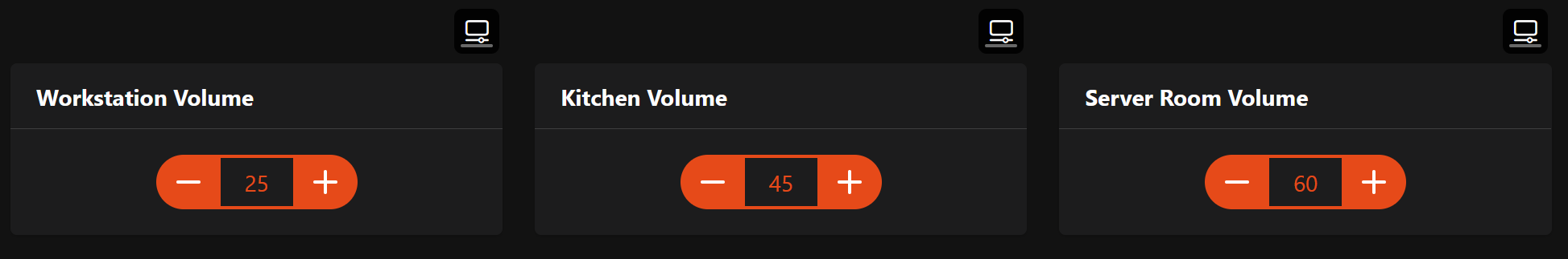

Okay, “widget” was a helpful keyword in your reply. Looking around the add-ons section, I found Rich Koshak’s volume control widget.
It does work, it does what it says, the range is correct for the item. Nice one!

I didn’t write that volume slider, I just configured the oh-slider-item widget an save that configuration off as a custom widget. If you installed this from the Marketplace you can go to Developer Tools → Widgets → rlk-volume-setpointlist and see the “code” that went into it. It’s basically just the setting of a couple of parameters and configuring the built in widget to look how I want it.
For the most part it’s hardly worth posting to the Marketplace but I wanted to put it up there so that other widget creators can see that their widget doesn’t need to be really big and complicated to be posted to the Marketplace. Also, there might be the ability to bundle multiple widgets on the marketplace in which case I could take most of those widgets and create a sort of theme that users can install and apply.
A note about application. Once you have a custom widget you should then go to your individual Items and set the “default x widget” metadata to use the appropriate custom widget. Then where ever that Item is shown it will choose the custom widget to display it instead of the system default.
A List Item type widget (which is what this volume slider widget is) is used inside of cards (e.g. in the Location cards on the Overview Page. A stand alone widget is used on a Layout page you might define from scratch.

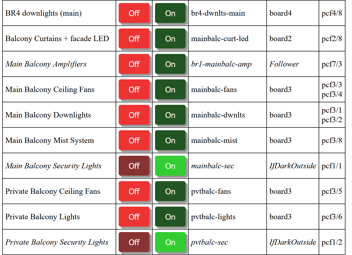

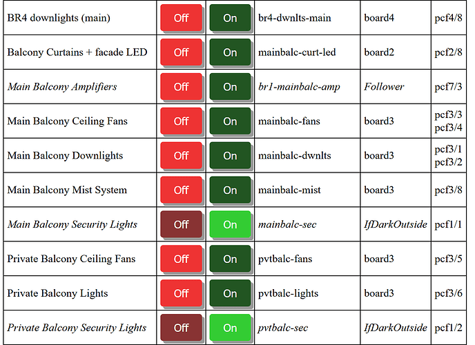

Simple web interface on ESP8266/ESP32 for direct control of my relay boards. These are the ones I will control from OH3 through Homie/MQTT once I get the hang of this. Mostly HTML with just enough CSS, JS and websockets sprinkled in to make it work.
It was hugely helpful for me to see it there! It was a working example of what I was looking for, just enough to point me in the right direction for making my own volume control widget based on oh-stepper-card.
