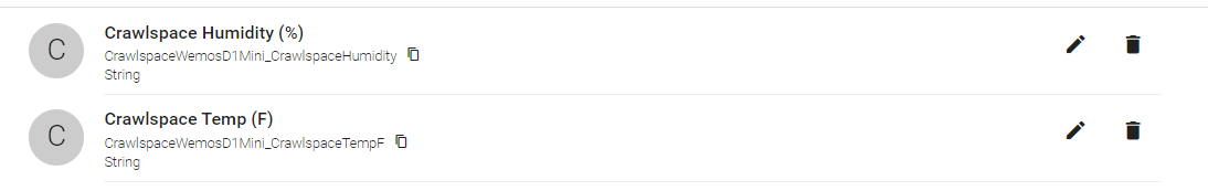

Here is a shot of my Items from Paperspace
I have the InfluxDB installed as an Addon and using it as default Persisence in System Configuration.

Your Items are of string type, not suitable for charting with Grafana.
That is what I thought…Is there a way to send items through MQTT to InfluxDB by changing the Arduino code? Or is there a way to reformat the data prior to it being stored into InfluxDB without adding another service/software?
Configure the MQTT Channels to be number instead of text types. Change the type of the Items to Number instead of String. You will probably have to delete the old entries in InfluxDB as most databases don’t like it when you change the type of an Item. Using a new Item name would also work.
That was it. I assumed it was necessary to make the Things and Items strings due to the MQTT being sent with a format of string. I guess the values are transformed in Openhab?
