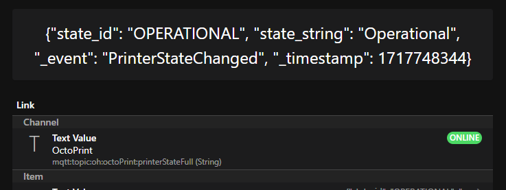

@jimtng thanks for the above.
Based on the above printerStateFull thing, I’m getting the following:
Many thanks,

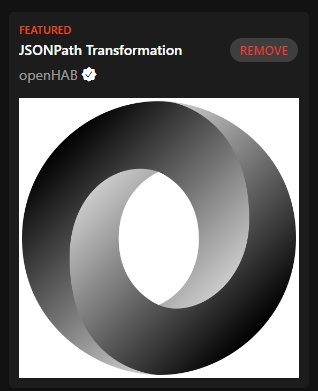

Is the jsonpath transformation addon installed?
It is indeed, other jsonpath transformations are working as expected…
