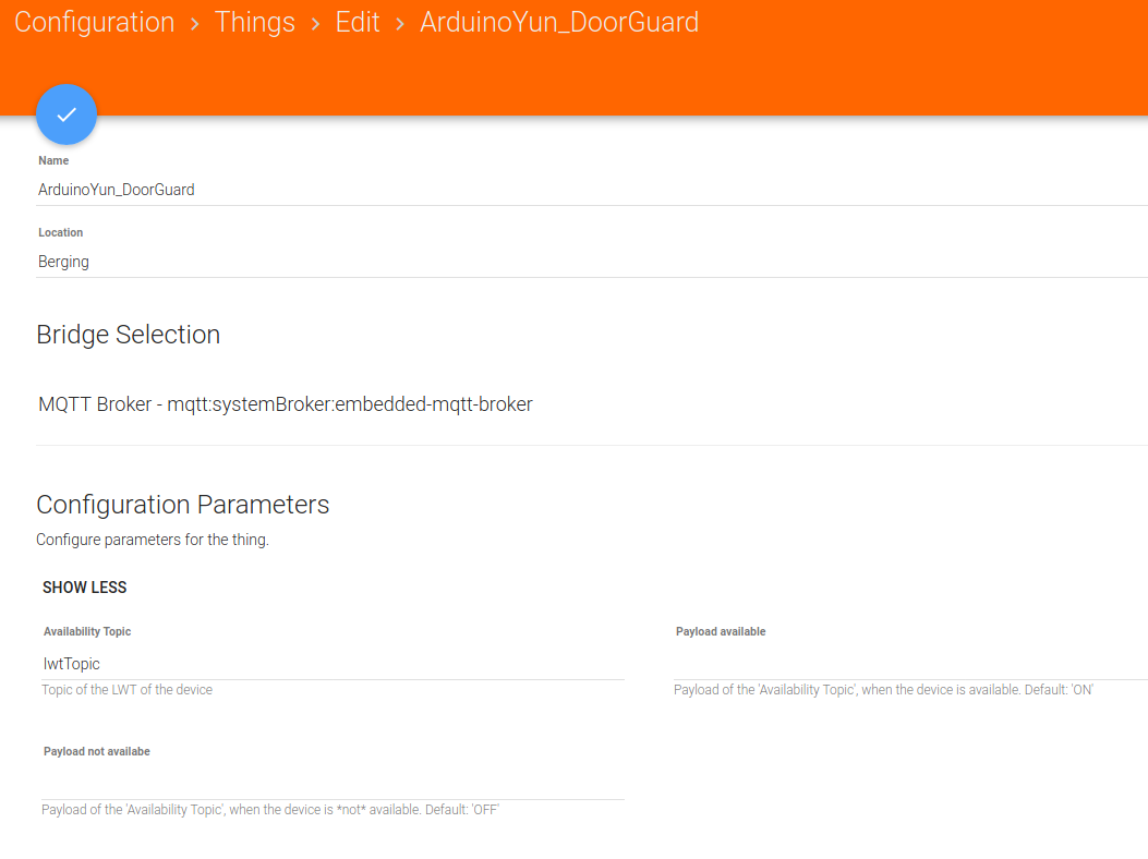

My configuration
I want to make a channel that shows if my ArduinoYun Thing is disconnected or not. How can I achieve that ? I’m also not sure what I should fill in in the 3 LWT configuration parameters of the mqtt ArduinoYun Thing.

Your screenshot shows configuration for your Thing. It is valid to enter LWT details here, but if
is actually what you’re after then you need to configure a new Channel within your Thing. There’s a few examples on this forum, but search is currently broken. This post I wrote has details on how to configure a Channel using files rather than PaperUI, but the concept is the same.

Now look at the documentation under the “Payload available” and “Payload not available”. What that is trying to tell you is that by default it is looking for an “ON” message to indicate that the device is online and an “OFF” message to indicate that the device is offline. If you want to override the default, you just need to type in the message that will be published to the LWT topic to indicate it’s online and the message that indicates it’s offline (X given your Arduino code above).
