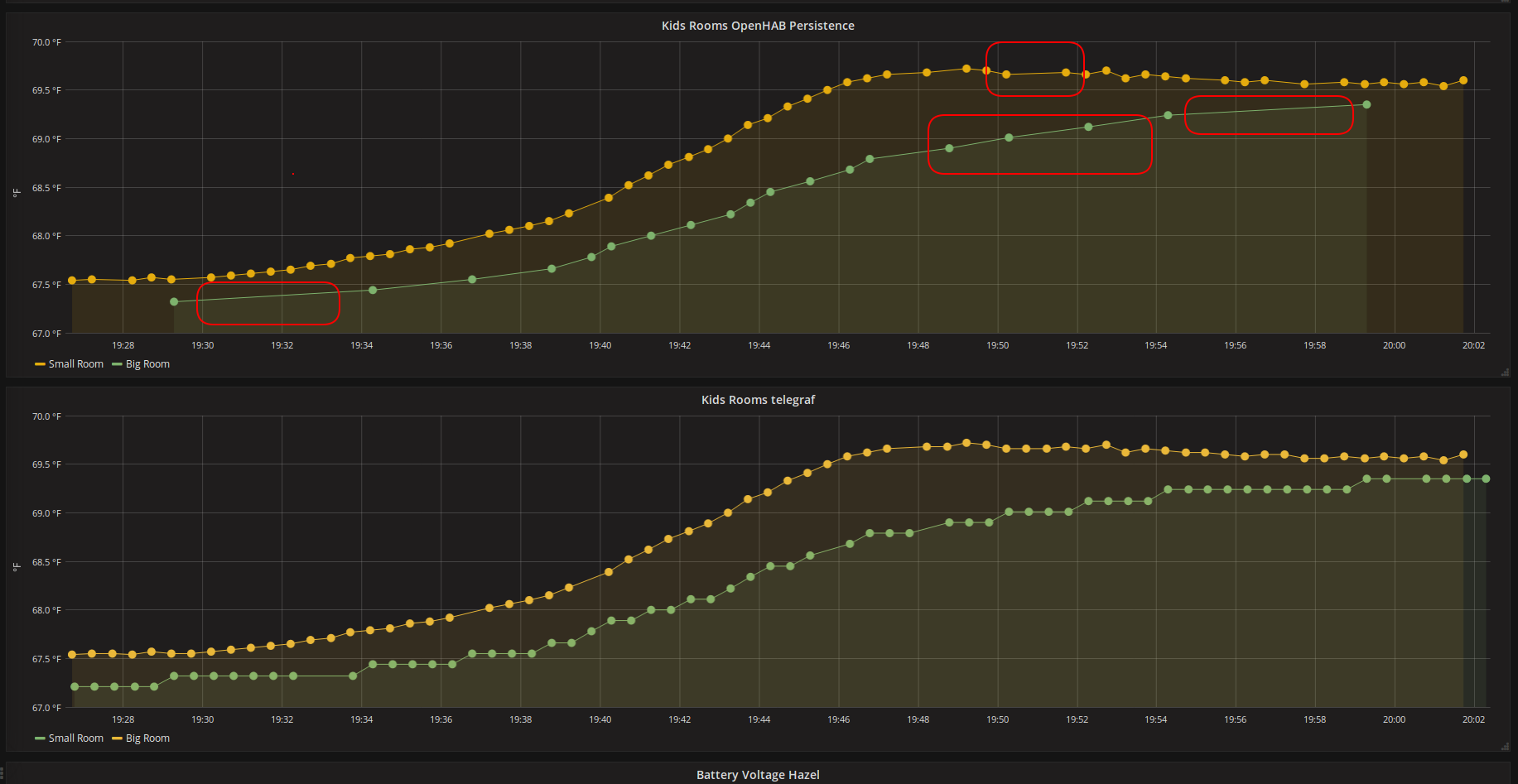

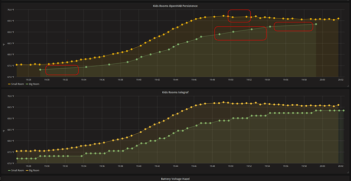

I can see this in the </var/log/events.log> missing MQTT events. I’m also persisting the MQTT data to InfluxDB via OpenHAB’s persistence service. At the same time, I’m using Telegraf to subscribe to the same MQTT events (a component service of Influx). I can see that the data from OpenHAB’s Influx persistence isn’t as complete as the Telegraf MQTT-to-Influx series.
It seems like Telegraf is much better at ingesting MQTT data, and the QoS setting actually effects reliability. I’m not sure the QoS setting in OpenHAB’s MQTT plugin is effecting subscription performance much.
