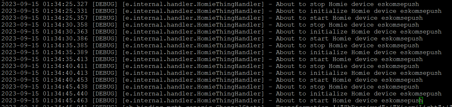

Well after enabling debug for the mqtthomie, I did note that the homie thing is starting and stopping without raising an error.i will post the entries. Seems to be an issue on mqtt on OH, I enabled mqtt generic debug, but I have not yet picked up anything to go on. The behaviour is showing that MQTT broker is having issues. Today after multiple restarts I found the broker being the main trouble. Not sure if there is a way reset the mqtt binding without loosing the current devices which are a mix of manually created things and automatically detected things.

here is the portion for the Homie debug log
