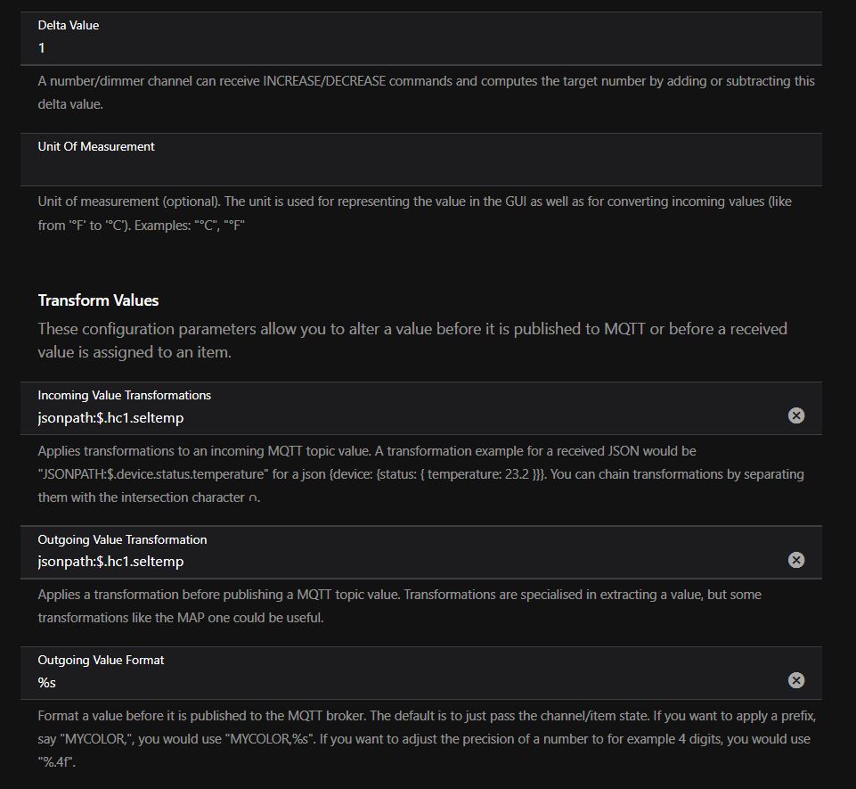

I also successfully use an MQTT broker. Reading values ​​works fine. Settings write but unfortunately not.
In the example here I want to write the target temperature, but somehow it doesn’t work that way. What am I doing wrong?

the JSONPATH-syntax seems alright though: $.hc1.seltemp should send 23 with a correct JSON.

  • you should almost never have the same state topic (OH reads messages) and the same command topic (OH writes messages). This can easily result in infinite loops. Some devices will use MQTT in bad ways and reuse the same topic for both. I don’t know ems-esp as to whether they do that. But usually you’d have a state topic and a separate command topic.
  • It would be very unusual to have the same transformation on the incoming and outgoing messages. For the transform to work like that the data would have to be the same coming and going in which case, what’s the purpose of the transform? But this really doesn’t make sense. When you receive the incoming message the JSONPATH transformation strips out the $.hc1.seltemp value which means your Item gets set to just a Number. That means this Channel is linked to a Number Item. And that means to send a command to that Item, and therefore publish a message, the Outgoing Value is just going to be a Number. You can’t run a JSONPATH transformation on just a Number. If you need to send that whole big JSON as the message, this is definitely not going to work.
OK, thank you, this make Sense, so i must found Out which are the send commands…

      transformationPatternOut: jsonpath:$.hc1.seltemp
      max: 30
      commandTopic: ems-esp/thermostat_data
      stateTopic: ems-esp/thermostat_data
      transformationPattern: jsonpath:$.hc1.seltemp
Hi, ok i got it:
described here: https://emsesp.github.io/docs/#/Command?id=mqtt
here is the correct commandTopic…
  - id: seltemp
    channelTypeUID: mqtt:number
    label: Ausgewaehlte Raumtemperatur
    description: ""
    configuration:
      commandTopic: ems-esp/thermostat/seltemp
      postCommand: false
      min: 17
      max: 30
thanks
