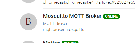

OK, So I removed the MQTT binding and deleted the Generic MQTT thing. I rebooted the system and they were gone from the PaperUI. I re-added the MQTT binding through the addon.cfg file and both MQTT Broker things came back. I just can’t figure out how to get rid of the one MQTT Broker thing. If, by chance, I accidentally installed the embedded broker, how do I get rid of it?

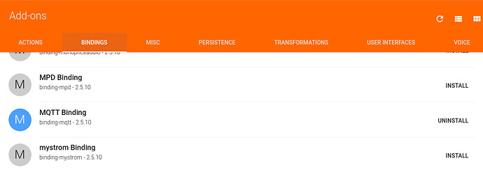

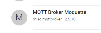

Are you looking under “Misc” in the PaperUI Add-ons? That’s where you’ll find the embedded broker. It’s called Moquette.
Since you’ve now configured your Mosquitto broker in a .thing file, you should ignore the one that pops into the PaperUI inbox. That’s PaperUI trying to help you out with auto-discovery, but you’ve already set up your broker via a config file. In the end, you want one of these:
I said earlier that I don’t use PaperUI, but I wasn’t quite correct. I used the broker thing that was auto-discovered by PaperUI, and then I defined each Tasmota device in my config file. That’s why my example early in this thread didn’t have a broker in the config file.
Hi Russ,
I looked in the Add-ons:
So the embedded broker is not installed. The MQTT binding is installed:

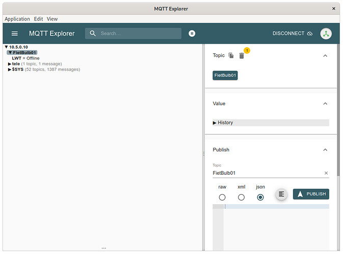

I tried working with MQTT Explorer, but this is all I get once I designate the server:
I must be missing something, but I just can’t see it.
Yay you are 99.9% there
In your mqtt window delete the FietBulb01 topic. (its a retained message from old settings)

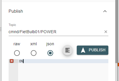

Then do this
Publish and your light should come on
Can you check this works first.
You can also use tasmota to switch and see the state in MQTTE
I did what you said and this is what I got:
The light didn’t turn on.

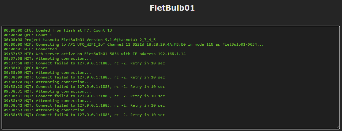

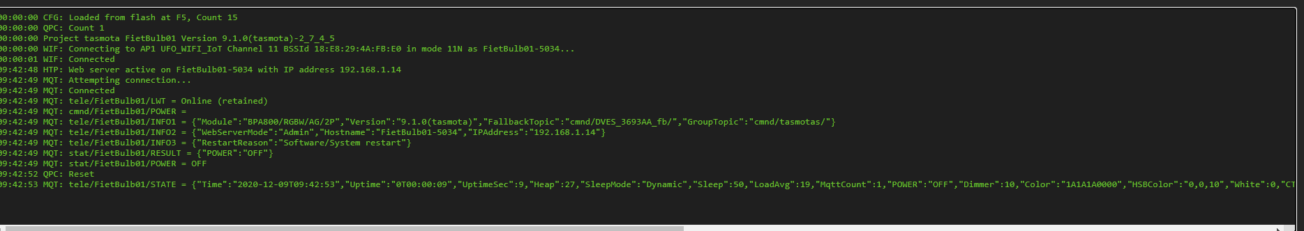

Can you turn the bulb on and off using the tasmota webpage and then see what happens in MQTT
Here it is… (I have no clue what I’m looking for)…
I need to get some sleep for work tomorrow…
You’re bulb is not connecting to MQTT dose your console show an error like
You may need to change your settings to
then check the console and you should see
Then stuff should show up in MQTTE and you should be able to see fancy things
Once you get this working then look at openHAB

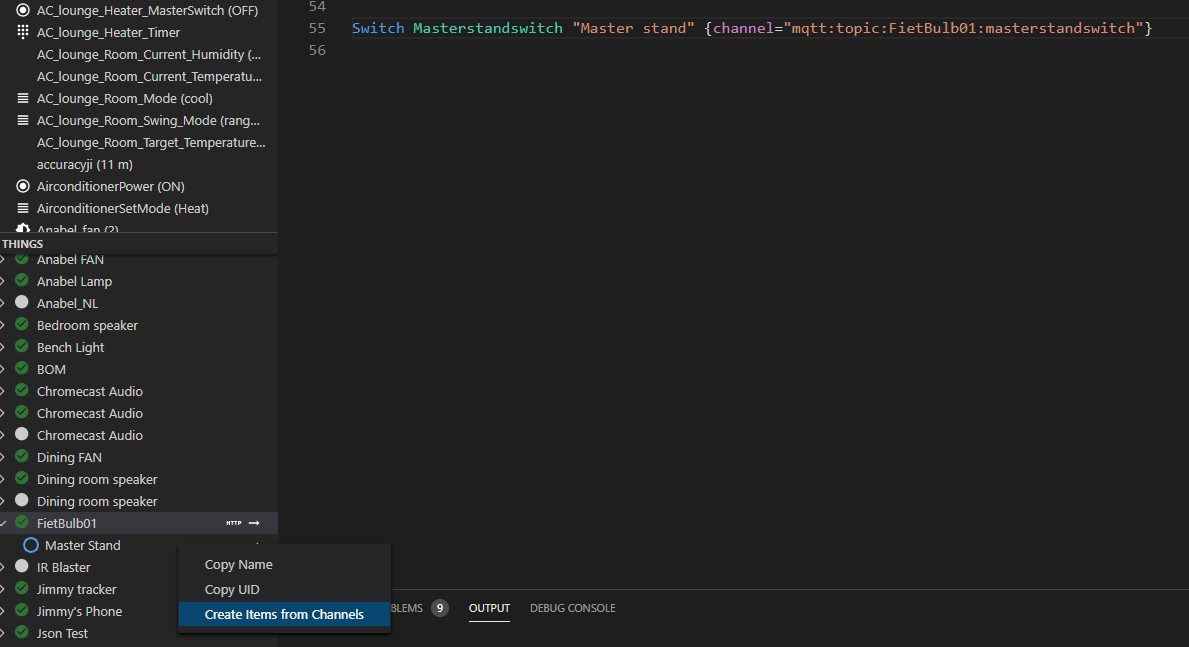

Then create the item, this is how I do it to save spelling mistakes and syntax error
Create Items from channels

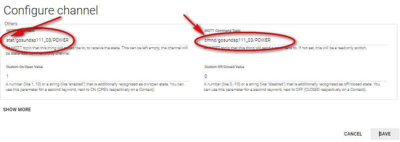

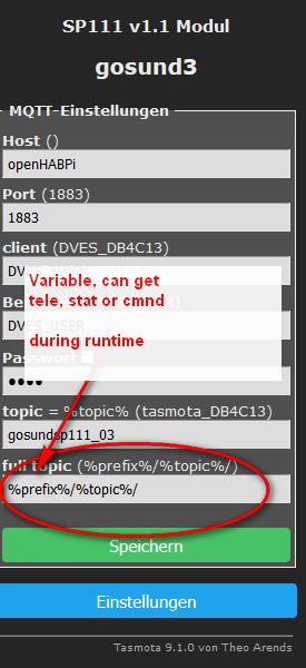

I didn’t read the whole post, but in a former screenshot I saw your channel-configuration. I think you should change it.
If you have the standard-tasmota settings in your Switch the channel topics should look like here:
Settings in tasmota:
Hope this can help.
I saw the errors mentioned:
I made the following changes to the Tasmota:
And got the following results:
Openhab can now control the bulb.
