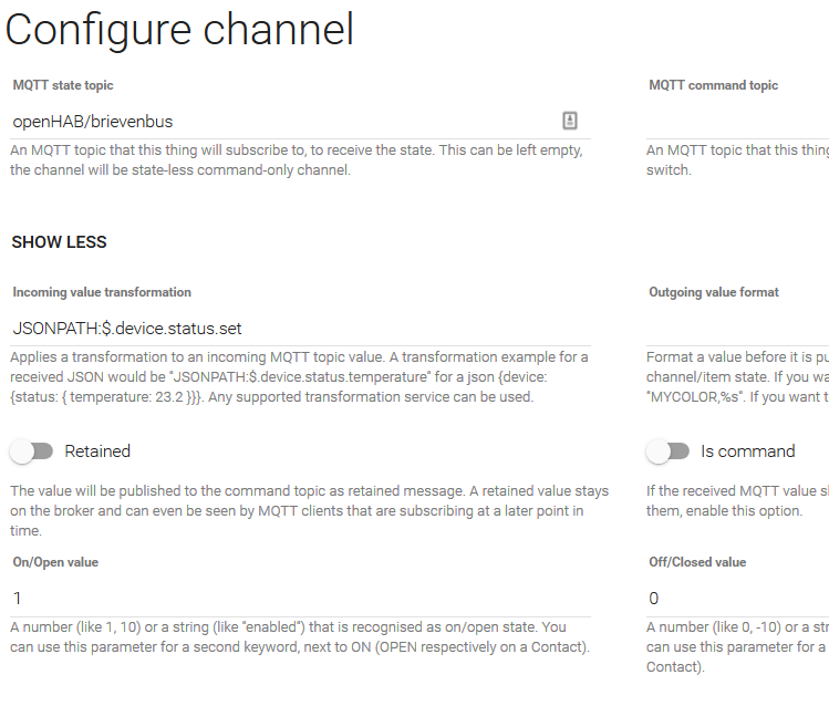

I receive mqtt data {device: {status: { set: 1}}} (which i am not able to change)
I have added JSONPATH:$.device.status.set
For the On/Open value I have added 1
Switch ErIsPost "Er is post" {mqtt="<[mqtt:topic:MQTTgeneric:postSchakelaar]"}
if I don’t add the 1 in the channel setting i get an error
2019-11-09 09:35:45.680 [WARN ] [eneric.internal.generic.ChannelState] - Command '1' not supported by type 'OnOffValue': No enum constant org.eclipse.smarthome.core.library.types.OnOffType.1
with a 1 in it there are no errors but the switch didn’t change.

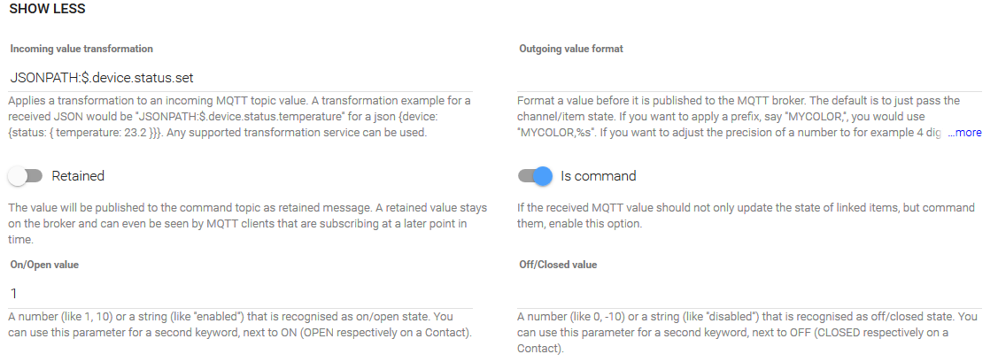

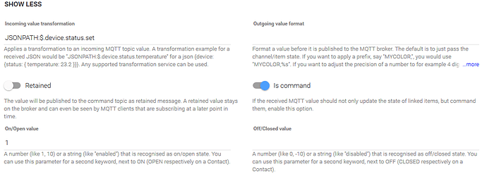

Turn off the Is Command option
@vzorglub
I have turned off the Is command switch no difference

Your channel set up looks correct

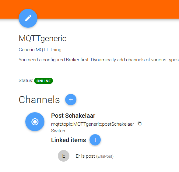

Can you show me this screen? Or your equivalent
@vzorglub
my item definition is at my first post
and this is my item in the item file
Switch ErIsPost “Er is post” {mqtt=“<[mqtt:topic:MQTTgeneric:postSchakelaar]”}

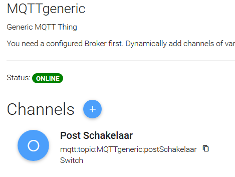

It is working I forgot Linked Items. Thanks a lot your picture helpt me out

Just adding Linked item that made it work
When i remove it in the paperUI it is not working
