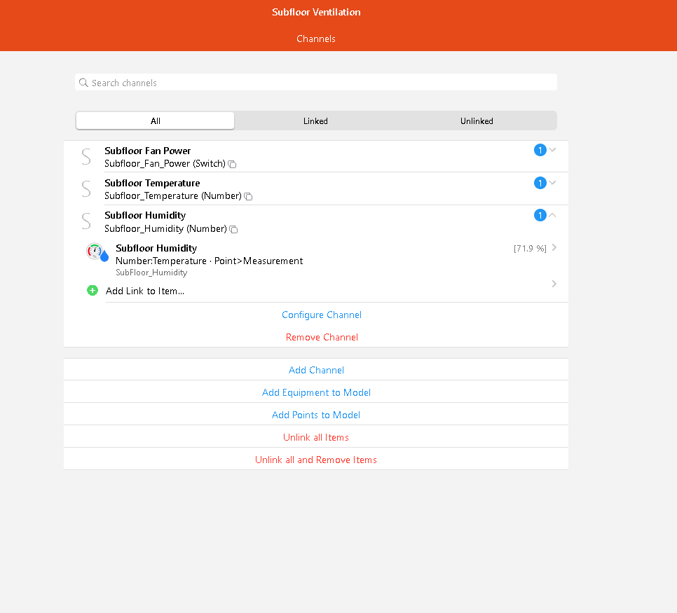

And the Channel has this value, which is very old/wrong (Actual sonof shows humidity 51% for example)
May someone point me in the right direction?

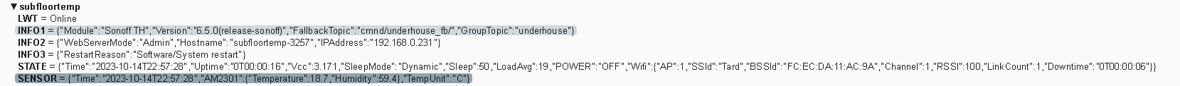

10
MQTT Explorer has this:
So i think the topic is the same for Temp, Humidity right?

What does the tele topic look like on the device console?
dastrix80
(Kris K)
October 14, 2023, 10:14pm
12
23:14:13 LOG: SerialLog 2, WebLog 2, SysLog 0, LogHost domus1, LogPort 514, TelePeriod 300
23:14:33 LOG: SerialLog 2, WebLog 2, SysLog 0, LogHost domus1, LogPort 514, TelePeriod 60
23:14:33 MQT: tele/subfloortemp/STATE = {"Time":"2023-10-14T23:14:33","Uptime":"0T00:15:04","Vcc":3.171,"SleepMode":"Dynamic","Sleep":50,"LoadAvg":19,"POWER":"OFF","Wifi":{"AP":1,"SSId":"Tard","BSSId":"FC:EC:DA:11:AC:9A","Channel":1,"RSSI":100,"LinkCount":1,"Downtime":"0T00:00:03"}}
23:14:33 MQT: tele/subfloortemp/SENSOR = {"Time":"2023-10-14T23:14:33","AM2301":{"Temperature":18.7,"Humidity":56.0},"TempUnit":"C"}
ubeaut

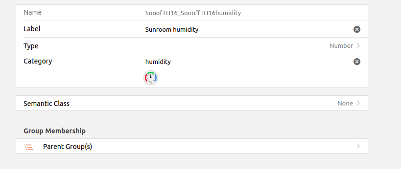

dastrix80:
unit: "%"
The only difference I have is I don’t bother with password for my mqtt. But if that were the case the power switch would not work either.

dastrix80:
Ive got another in my ceiling that has the same configuration, it too works
This must be a Openhab bug
Are there any message in OH log?
Is your item constantly showing the same wrong value → not updating at all OR randomly showing different values, but updating?
Your humidity item is number:temperature - as humidity is % and not °C I would choose number: dimensionless as type.

My items are just numbers and they work:
dastrix80

October 16, 2023, 6:24pm
18
Edit: plain ol number seems to have fixed it! Thankyou!
