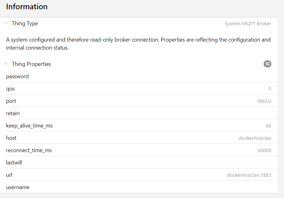

I have configured the a system broker:
  • tesport3
  • brokerhost: dockerhost.lan
  • secure connection: no
  • Client ID:testport3
This results in a MQTT Broker thing
But with status ERROR:COMM
the log shows:

alright, I did manage to get a working connection but without much joy: the internal system broker doesn’t publish internal events. (it may not be a broker at all, just another client as @denominator indicated)
I believe the root cause of this little exploration is due to a combination of some unfortunate UI design and/or messy config handling: the settings->mqtt system broker UI allows to change settings and save them - but they are ignored by OH unless you also change the connection name (IIRC) … which then creates a new thing, and so on.
So unless you change the connection name you end up with two bits of UI that are out of sync.
(it also doesn’t help that even if you change the connection the old connection can still be retrying and filling up the logs)
