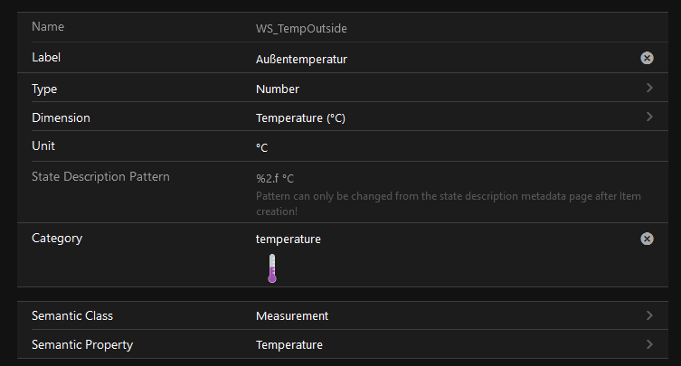

mqtt-channel for outside temp:
  - id: WetterstationTempOutside
    channelTypeUID: mqtt:number
    label: Außentemperatur
    configuration:
      postCommand: false
      min: -30
      stateTopic: devices/Wetterstation/tempOutsideC
      max: 60
      unit: °C // optional
bonus: you can optionally define the unit of an mqtt-channel (last line)

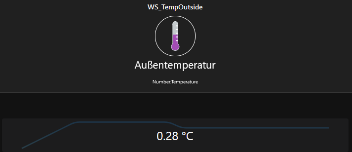

the topic sends already Celsius, so I just define at the linked item:
which then leads to:

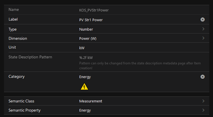

now for the more “complicated” one, this time a channel of my solar inverter for the current PV power:
  - id: powerDC1
    label: PV-Erzeugung PV-String1
    description: 260- Power DC1
    configuration:
      stateTopic: devices/Kostal/powerDC1
      unit: W
this time the unit at the channel is important, because I’d like to show it in openHAB as kW, not W.
(I could have changed the unit in my Node-Red flow, which reads out the inverter and sends seperate mqtt-topics for each information, but I leave the unit as is)
on item level you can then simply configure kW:
which in turn leads to using kW as the unit for the item, even if the value is sent unitless, but in W.

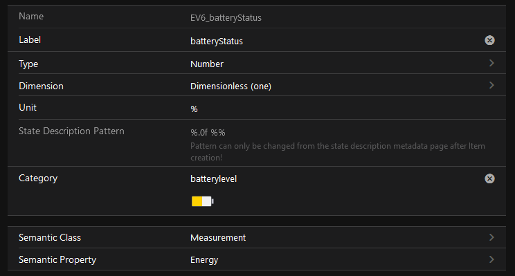

and it even works that same way with dimensionless values like percentages of SoC.
channel:
  - id: batteryStatus
    label: batteryStatus
    description: Fahrzeug Status
    configuration:
      stateTopic: devices/KiaEV6/batteryStatus
      unit: "%"
item:
