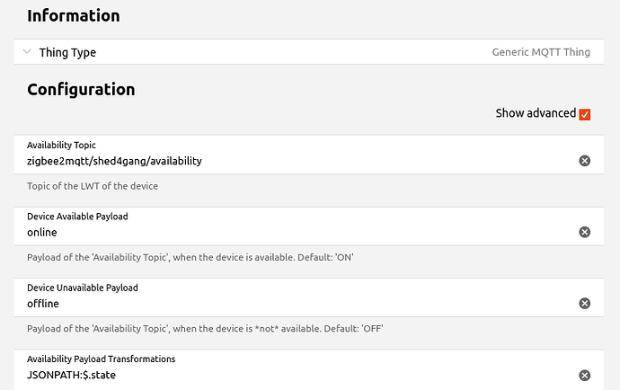

The thing might be missing the availability.
You have to click advanced on the thing to see the options.
UID: mqtt:topic:mqttbroker:shed4gang
label: Shed 4 gang zigbee switch
thingTypeUID: mqtt:topic
configuration:
  payloadNotAvailable: offline
  payloadAvailable: online
  transformationPattern:
    - JSONPATH:$.state
  availabilityTopic: zigbee2mqtt/shed4gang/availability
bridgeUID: mqtt:broker:mqttbroker
It should look like this:

Yes mine works because I have the transformation.
Like you I had to change this with different version changes.
It used to work with just offline and online without the transformation.
