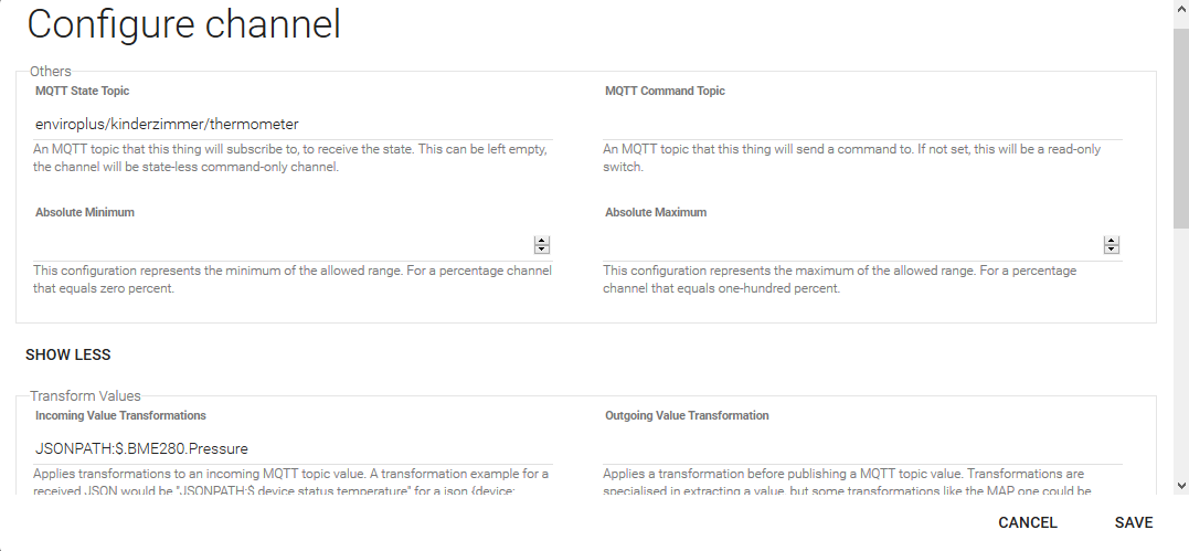

I have set up a small weather station based on a RPI Zero W with Pimoroni Enviro (sensors: BME280, LTR-559 & noise sensor) and send the data via MQTT to my broker. There .json data arrives. The connection also works. I have tested this with a MQTT.fx client.
Since I am still quite new in the whole automation topic, I can’t find out how to get displayable values for my OH2 from the .json values. It seems that I need the JSONPATH Transformation Binding, which I have also installed via the PaperUI.
Can someone please explain to me step by step what is necessary? I am just at the end of my Latin. I thank you very much.

Hej folks, please excuse me for not creating a forum conform request. I have already read several documentations and just did not know what to do. I definitely do not expect complete soultions, because I want to learn something.
To your questions:
That is what I tried to describe above. I tried to transform my generated .json data to display it in OH. Unfortunately the command did not work or something is missing.
Although, as written above, I have already read various documentations, I did not know until now that I had to create a Thing configuration. So far I have only created a MQTT Generic Thing and tried to link my values via a channel.
Number   Sensor_MasterTemperature    "Temperatur [%.1f °C]"   <temperature> (gSensorTemperature)  { mqtt="<[broker:enviroplus/kinderzimmer/thermometer:state:JSONPATH($.BME280.Temperature)]" }

If this is the full JSON message:
{'temperature': 11, 'pressure': 630, 'humidity': 134, 'lux': 0, 'serial': '00000000fd34758f'}
Then it looks like you only need to use the following for your JSONPATH transformation:
JSONPATH:$.pressure
For Incoming Value Transformation
Although I’m slightly confused about the three JSON messages you show - are they at different times? Different sensors?
Note also that your Items are using v1 MQTT binding configuration, but it looks like you’re using the V2 MQTT binding. See here for how to set that up:
https://github.com/openhab/openhab-addons/blob/main/bundles/org.openhab.binding.mqtt.generic/xtend_examples.md

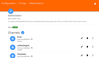

I see no new Thing in my PaperUI. I thought a new Thing is created with the file?
Unfortunately this does not say anything. I save the Thing in the directory /srv/openhab2-conf/things with the title thermometer.things
