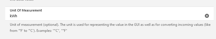

  1. I have a “Generic MQTT Device” and define a new Channel with “UoM” = kWh.

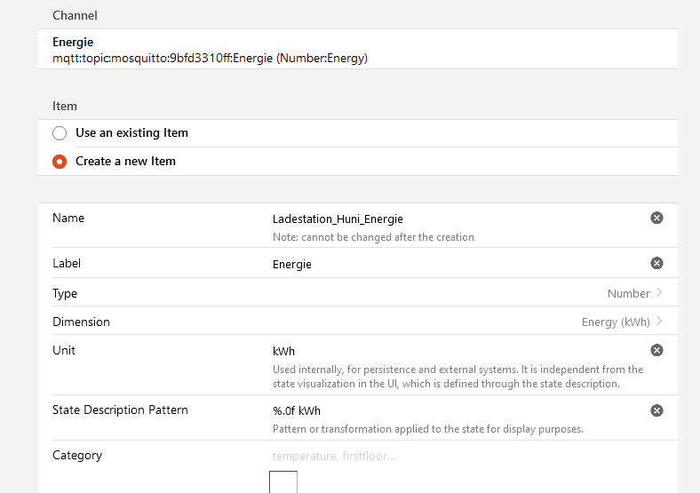

  2. I create a new item and its already suggesting the right settings for “Unit” and “State Description Pattern”

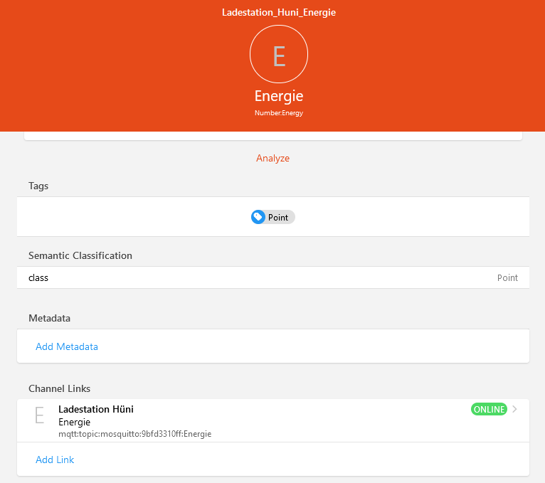

  3. As soon as I create the item the Metadata settings are not made:
Does anyone have the same problem?
