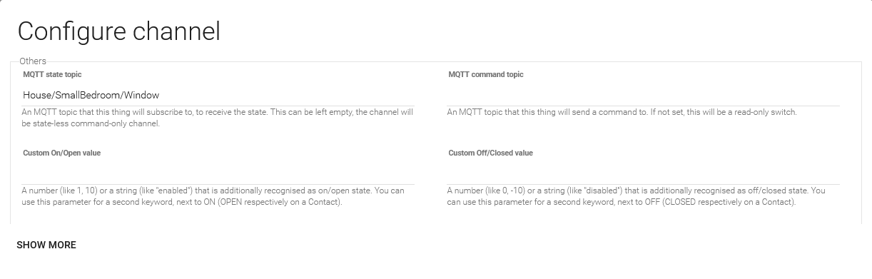

this what i read on me front tail,
“[ab.binding.mqtt.generic.ChannelState] - Command ‘1’ not supported by type ‘OpenCloseValue’: No enum constant org.eclipse.smarthome.core.library.types.OpenClosedType.1”
actually i send to openhab value from broker Mqtt, these value is “0” or “1”
here is one item :
Contact EtatPorteArriere “Etat porte Arrière [%s]” (Salon,It_Group_Contact) {channel=“mqtt:topic:6b353ec8:EtatPorteArriere”}
i try to change to Number or String but same error
thanks for the help ! realy.
so i try with your tricks but same error so i move to my test rasberryPi3 on openhab 2.4 , i recreate the mqtt with the same type , and this time no error ! even i can convert the numeric value for exemple “0” simply by chose in the item file the type “Contact” or “Number” or “String” no error without mapping…, strange no ?
