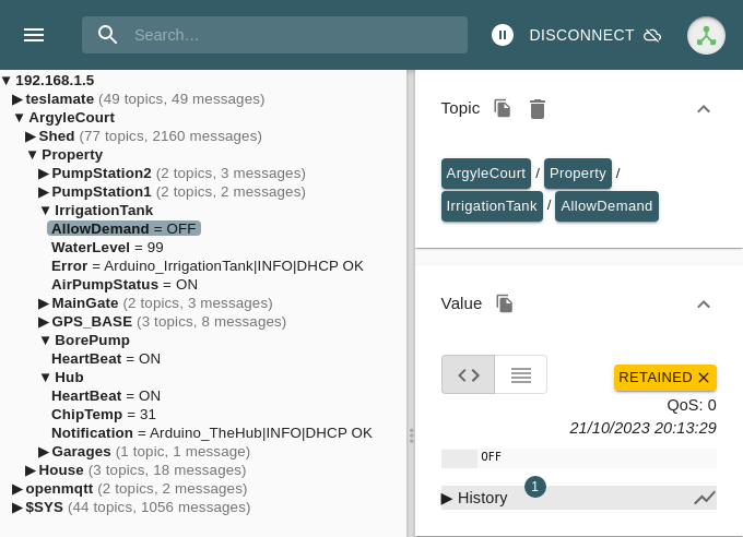

Retain may be the cue.
If sending a message to the broker, you can set the message to be retained. Mosquitto will then save the message. If a client subscribes to this topic, the retained message is delivered instantly.
If using an mqtt sniffer such as MQTT Explorer, you can see if a topic is retained.
Yes, you seem to be onto something, what I suspected, but can’t figure out. Any MQTT message only shows up when a msg has been sent. This one, AllowDemand is always OFF when I connect to it, as it did just now, opening MQTT Explorer.
Select AllowDemand and take a look at the right side :slight_smile:
Genius :slight_smile: I should learn to understand my tools better.
Yes, it has a RETAINED label.

I just deleted the retained label/message.
This seems to have done it.
