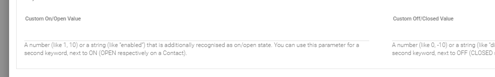

Correct. You cannot send ON/OFF to a Contact. You can only send OPEN/CLOSED. You need to transform the “ON”/“OFF” you are receiving to OPEN/CLOSED. I could show you in a second how to do it in PaperUI. Can’t help with .things files.
Please show me the PaperUI Method, I’ll can then experiment. I already have to use it with one of my other things due to translations not working with text files.
Fill in those two fields with the value you get from the message that you want to correspond with OPEN and CLOSED. So if you receive “ON”, put “ON” in the “Custom On/Open Value”
