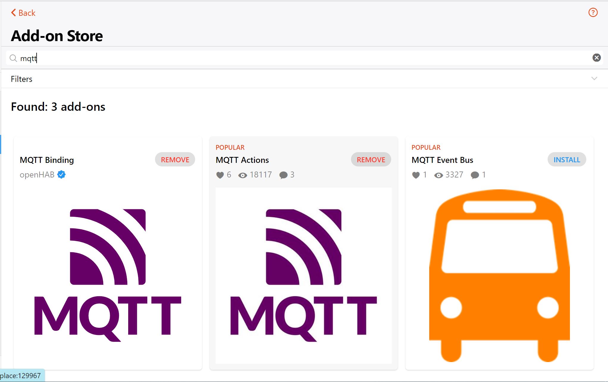

There isn’t a separate MQTT Actions binding. What exactly did you install and how did you install it?
The original error is weird too. What does MQTT have to do with Sonoff?
This is what I reinstalled from the add on store through the web UI.
