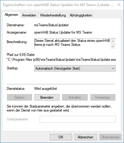

    • msTeamsStatusUpdater.exe install
  • The commandline should show you a success message
  • Open your services.msc and search for your new service
  • Open the preferences and start your service
  • Check your openHAB item and if it´s changing to Online
  • Open your MS Teams, try to change the status and see if it´s pushed to openHAB
