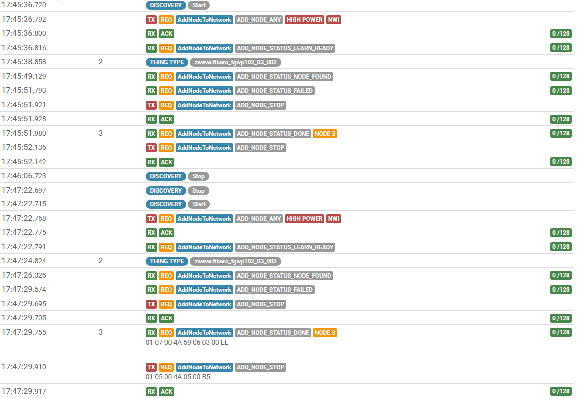

I think it is in align with manual…
here are DEBUG logs from now:

2018-12-02 17:45:36.897 [DEBUG] [ve.internal.protocol.ZWaveController] - Incoming Message: Message: class=AddNodeToNetwork[74], type=Request[0], dest=1, callback=85, payload=55 01 00 00
2018-12-02 17:45:36.901 [DEBUG] [ol.serialmessage.AddNodeMessageClass] - Add Node: Learn ready.
2018-12-02 17:45:36.906 [DEBUG] [al.protocol.ZWaveInclusionController] - Inclusion event: Current state IncludeSent, new event IncludeStart
2018-12-02 17:45:36.911 [DEBUG] [e.internal.protocol.ZWaveTransaction] - TID 59: Transaction COMPLETED
2018-12-02 17:45:36.917 [DEBUG] [nal.protocol.ZWaveTransactionManager] - NODE 255: Response processed after 81ms
2018-12-02 17:45:36.920 [DEBUG] [nal.protocol.ZWaveTransactionManager] - NODE 255: TID 59: Transaction completed
2018-12-02 17:45:36.925 [DEBUG] [nal.protocol.ZWaveTransactionManager] - NODE 255: notifyTransactionResponse TID:59 DONE
2018-12-02 17:45:36.933 [DEBUG] [nal.protocol.ZWaveTransactionManager] - ZWaveReceiveThread queue empty
2018-12-02 17:45:36.937 [DEBUG] [nal.protocol.ZWaveTransactionManager] - Transaction SendNextMessage 0 out at start. Holdoff false.

2018-12-02 17:45:49.218 [DEBUG] [ol.serialmessage.AddNodeMessageClass] - Add Node: New node found.
2018-12-02 17:45:49.225 [DEBUG] [nal.protocol.ZWaveTransactionManager] - ZWaveReceiveThread queue empty
2018-12-02 17:45:49.231 [DEBUG] [nal.protocol.ZWaveTransactionManager] - Transaction SendNextMessage 0 out at start. Holdoff false.
2018-12-02 17:45:51.793 [DEBUG] [WaveSerialHandler$ZWaveReceiveThread] - Receive Message = 01 07 00 4A 55 07 03 00 E3
2018-12-02 17:45:51.829 [DEBUG] [nal.protocol.ZWaveTransactionManager] - processReceiveMessage input 0<>128 : Message: class=AddNodeToNetwork[74], type=Request[0], dest=7, callback=85, payload=55 07 03 00
2018-12-02 17:45:51.836 [DEBUG] [nal.protocol.ZWaveTransactionManager] - Received msg (0): Message: class=AddNodeToNetwork[74], type=Request[0], dest=7, callback=85, payload=55 07 03 00
2018-12-02 17:45:51.842 [DEBUG] [nal.protocol.ZWaveTransactionManager] - lastTransaction null
2018-12-02 17:45:51.851 [DEBUG] [nal.protocol.ZWaveTransactionManager] - Checking outstanding transactions: 0
2018-12-02 17:45:51.858 [DEBUG] [nal.protocol.ZWaveTransactionManager] - Last transaction: null
2018-12-02 17:45:51.866 [DEBUG] [ve.internal.protocol.ZWaveController] - Incoming Message: Message: class=AddNodeToNetwork[74], type=Request[0], dest=7, callback=85, payload=55 07 03 00
2018-12-02 17:45:51.874 [DEBUG] [ol.serialmessage.AddNodeMessageClass] - Add Node: Failed.
2018-12-02 17:45:51.883 [DEBUG] [al.protocol.ZWaveInclusionController] - Inclusion event: Current state IncludeStart, new event IncludeFail
2018-12-02 17:45:51.889 [DEBUG] [ol.serialmessage.AddNodeMessageClass] - Ending INCLUSION mode.

2018-12-02 17:45:52.046 [DEBUG] [ol.serialmessage.AddNodeMessageClass] - Add Node: Done.
2018-12-02 17:45:52.050 [DEBUG] [wave.discovery.ZWaveDiscoveryService] - NODE 3: Device discovered
2018-12-02 17:45:52.058 [DEBUG] [al.protocol.ZWaveInclusionController] - Inclusion event: Current state IncludeFail, new event IncludeDone
2018-12-02 17:45:52.065 [DEBUG] [ol.serialmessage.AddNodeMessageClass] - Ending INCLUSION mode.

2018-12-02 17:45:55.216 [DEBUG] [org.openhab.binding.zwave ] - ServiceEvent REGISTERED - {org.eclipse.smarthome.config.core.status.ConfigStatusProvider}={service.id=368, service.bundleid=201, service.scope=singleton} - org.openhab.binding.zwave
2018-12-02 17:45:55.259 [DEBUG] [ding.zwave.handler.ZWaveThingHandler] - Initializing ZWave thing handler zwave:device:6f2c0bd3:node3.
2018-12-02 17:45:55.279 [DEBUG] [ding.zwave.handler.ZWaveThingHandler] - NODE 3: MANUFACTURER not set
2018-12-02 17:45:55.283 [DEBUG] [ding.zwave.handler.ZWaveThingHandler] - NODE 3: Controller status changed to ONLINE.
2018-12-02 17:45:55.292 [DEBUG] [ding.zwave.handler.ZWaveThingHandler] - NODE 3: Controller is ONLINE. Starting device initialisation.
2018-12-02 17:45:55.314 [DEBUG] [ding.zwave.handler.ZWaveThingHandler] - NODE 3: Updating node properties.
2018-12-02 17:45:55.321 [DEBUG] [ding.zwave.handler.ZWaveThingHandler] - NODE 3: Updating node properties. MAN=2147483647
2018-12-02 17:45:55.326 [DEBUG] [ding.zwave.handler.ZWaveThingHandler] - NODE 3: Properties synchronised
2018-12-02 17:45:55.341 [DEBUG] [ve.internal.protocol.ZWaveController] - Event listener added.
2018-12-02 17:45:55.346 [DEBUG] [ding.zwave.handler.ZWaveThingHandler] - NODE 3: Initialising Thing Node…
2018-12-02 17:45:55.352 [DEBUG] [ding.zwave.handler.ZWaveThingHandler] - NODE 3: Polling intialised at 1800 seconds - start in 1024200 milliseconds.
2018-12-02 17:45:55.356 [DEBUG] [ding.zwave.handler.ZWaveThingHandler] - NODE 3: Device initialisation complete.
2018-12-02 17:45:57.178 [DEBUG] [sactionManager$ZWaveTransactionTimer] - NODE 255: TID 61: Timeout at state WAIT_REQUEST. 3 retries remaining.
2018-12-02 17:45:57.186 [DEBUG] [sactionManager$ZWaveTransactionTimer] - TID 61: Transaction is current transaction, so clearing!!!
2018-12-02 17:45:57.194 [DEBUG] [e.internal.protocol.ZWaveTransaction] - TID 61: Transaction CANCELLED
2018-12-02 17:45:57.200 [DEBUG] [nal.protocol.ZWaveTransactionManager] - NODE 255: notifyTransactionResponse TID:61 CANCELLED
2018-12-02 17:45:57.214 [DEBUG] [nal.protocol.ZWaveTransactionManager] - Transaction SendNextMessage 0 out at start. Holdoff false.
2018-12-02 17:46:06.723 [DEBUG] [wave.discovery.ZWaveDiscoveryService] - ZWave discovery: Stop zwave:serial_zstick:6f2c0bd3
2018-12-02 17:46:06.731 [DEBUG] [ve.internal.protocol.ZWaveController] - ZWave inclusion process not running - nothing to do
2018-12-02 17:47:22.697 [DEBUG] [wave.discovery.ZWaveDiscoveryService] - ZWave discovery: Stop zwave:serial_zstick:6f2c0bd3
2018-12-02 17:47:22.705 [DEBUG] [ve.internal.protocol.ZWaveController] - ZWave inclusion process not running - nothing to do
2018-12-02 17:47:22.715 [DEBUG] [wave.discovery.ZWaveDiscoveryService] - ZWave discovery: Start zwave:serial_zstick:6f2c0bd3
2018-12-02 17:47:22.722 [DEBUG] [ve.internal.protocol.ZWaveController] - ZWave controller start inclusion - mode 2
2018-12-02 17:47:22.730 [DEBUG] [ve.internal.protocol.ZWaveController] - Event listener added.
2018-12-02 17:47:22.739 [DEBUG] [al.protocol.ZWaveInclusionController] - ZWave controller start inclusion
2018-12-02 17:47:22.746 [DEBUG] [ol.serialmessage.AddNodeMessageClass] - Setting controller into INCLUSION mode, highPower:true networkWide:true.
2018-12-02 17:47:22.751 [DEBUG] [nal.protocol.ZWaveTransactionManager] - NODE 255: Added 62 to queue - size 1
2018-12-02 17:47:22.757 [DEBUG] [nal.protocol.ZWaveTransactionManager] - Transaction SendNextMessage 0 out at start. Holdoff false.
2018-12-02 17:47:22.763 [DEBUG] [wave.internal.protocol.SerialMessage] - Assembled message buffer = 01 05 00 4A C1 58 29
2018-12-02 17:47:22.768 [DEBUG] [ing.zwave.handler.ZWaveSerialHandler] - NODE 255: Sending REQUEST Message = 01 05 00 4A C1 58 29
2018-12-02 17:47:22.775 [DEBUG] [WaveSerialHandler$ZWaveReceiveThread] - Receive Message = 06
2018-12-02 17:47:22.779 [DEBUG] [nal.protocol.ZWaveTransactionManager] - processReceiveMessage input 0<>128 : Message: class=null[0], type=ACK[2], dest=255, callback=0, payload=
2018-12-02 17:47:22.783 [DEBUG] [nal.protocol.ZWaveTransactionManager] - Received msg (0): Message: class=null[0], type=ACK[2], dest=255, callback=0, payload=
2018-12-02 17:47:22.786 [DEBUG] [nal.protocol.ZWaveTransactionManager] - lastTransaction null
2018-12-02 17:47:22.790 [DEBUG] [nal.protocol.ZWaveTransactionManager] - Received msg: ACK
2018-12-02 17:47:22.791 [DEBUG] [WaveSerialHandler$ZWaveReceiveThread] - Receive Message = 01 07 00 4A 58 01 00 00 EB
2018-12-02 17:47:22.800 [DEBUG] [nal.protocol.ZWaveTransactionManager] - ZWaveReceiveThread queue empty
2018-12-02 17:47:22.798 [DEBUG] [ing.zwave.handler.ZWaveSerialHandler] - Message SENT
2018-12-02 17:47:22.809 [DEBUG] [nal.protocol.ZWaveTransactionManager] - Transaction SendNextMessage started: TID 62: [WAIT_REQUEST] priority=Controller, requiresResponse=true, callback: 88
2018-12-02 17:47:22.815 [DEBUG] [nal.protocol.ZWaveTransactionManager] - Transaction SendNextMessage 1 out at start. Holdoff false.
2018-12-02 17:47:22.838 [DEBUG] [nal.protocol.ZWaveTransactionManager] - processReceiveMessage input 0<>128 : Message: class=AddNodeToNetwork[74], type=Request[0], dest=1, callback=88, payload=58 01 00 00
2018-12-02 17:47:22.845 [DEBUG] [nal.protocol.ZWaveTransactionManager] - Received msg (0): Message: class=AddNodeToNetwork[74], type=Request[0], dest=1, callback=88, payload=58 01 00 00
2018-12-02 17:47:22.849 [DEBUG] [nal.protocol.ZWaveTransactionManager] - lastTransaction TID 62: [WAIT_REQUEST] priority=Controller, requiresResponse=true, callback: 88
2018-12-02 17:47:22.853 [DEBUG] [nal.protocol.ZWaveTransactionManager] - Checking outstanding transactions: 1
2018-12-02 17:47:22.858 [DEBUG] [nal.protocol.ZWaveTransactionManager] - Last transaction: TID 62: [WAIT_REQUEST] priority=Controller, requiresResponse=true, callback: 88
2018-12-02 17:47:22.862 [DEBUG] [nal.protocol.ZWaveTransactionManager] - Checking TID 62: (Callback 88)
2018-12-02 17:47:22.867 [DEBUG] [.serialmessage.ZWaveCommandProcessor] - Callback match!
2018-12-02 17:47:22.872 [DEBUG] [nal.protocol.ZWaveTransactionManager] - Correlated to TID 62: callback 88
2018-12-02 17:47:22.875 [DEBUG] [ve.internal.protocol.ZWaveController] - Incoming Message: Message: class=AddNodeToNetwork[74], type=Request[0], dest=1, callback=88, payload=58 01 00 00
2018-12-02 17:47:22.881 [DEBUG] [ol.serialmessage.AddNodeMessageClass] - Add Node: Learn ready.
2018-12-02 17:47:22.887 [DEBUG] [al.protocol.ZWaveInclusionController] - Inclusion event: Current state IncludeSent, new event IncludeStart
2018-12-02 17:47:22.892 [DEBUG] [e.internal.protocol.ZWaveTransaction] - TID 62: Transaction COMPLETED
2018-12-02 17:47:22.897 [DEBUG] [nal.protocol.ZWaveTransactionManager] - NODE 255: Response processed after 88ms
2018-12-02 17:47:22.901 [DEBUG] [nal.protocol.ZWaveTransactionManager] - NODE 255: TID 62: Transaction completed
2018-12-02 17:47:22.905 [DEBUG] [nal.protocol.ZWaveTransactionManager] - NODE 255: notifyTransactionResponse TID:62 DONE
2018-12-02 17:47:22.911 [DEBUG] [nal.protocol.ZWaveTransactionManager] - ZWaveReceiveThread queue empty
2018-12-02 17:47:22.914 [DEBUG] [nal.protocol.ZWaveTransactionManager] - Transaction SendNextMessage 0 out at start. Holdoff false.
2018-12-02 17:47:24.817 [DEBUG] [wave.discovery.ZWaveDiscoveryService] - NODE 2: Device discovery completed
2018-12-02 17:47:24.824 [DEBUG] [wave.discovery.ZWaveDiscoveryService] - NODE 2: Device discovery resolved to thingType zwave:fibaro_fgwp102_03_002
2018-12-02 17:47:24.840 [DEBUG] [wave.discovery.ZWaveDiscoveryService] - NODE 3: Device discovery completed
2018-12-02 17:47:24.854 [WARN ] [wave.discovery.ZWaveDiscoveryService] - NODE 3: Device discovery could not resolve to a thingType! Manufacturer data not known.
2018-12-02 17:47:24.869 [DEBUG] [wave.discovery.ZWaveDiscoveryService] - NODE 4: Device discovery completed
2018-12-02 17:47:24.885 [WARN ] [wave.discovery.ZWaveDiscoveryService] - NODE 4: Device discovery could not resolve to a thingType! Manufacturer data not known.
2018-12-02 17:47:26.326 [DEBUG] [WaveSerialHandler$ZWaveReceiveThread] - Receive Message = 01 07 00 4A 58 02 00 00 E8
2018-12-02 17:47:26.369 [DEBUG] [nal.protocol.ZWaveTransactionManager] - processReceiveMessage input 0<>128 : Message: class=AddNodeToNetwork[74], type=Request[0], dest=2, callback=88, payload=58 02 00 00
2018-12-02 17:47:26.376 [DEBUG] [nal.protocol.ZWaveTransactionManager] - Received msg (0): Message: class=AddNodeToNetwork[74], type=Request[0], dest=2, callback=88, payload=58 02 00 00
2018-12-02 17:47:26.382 [DEBUG] [nal.protocol.ZWaveTransactionManager] - lastTransaction null
2018-12-02 17:47:26.388 [DEBUG] [nal.protocol.ZWaveTransactionManager] - Checking outstanding transactions: 0
2018-12-02 17:47:26.393 [DEBUG] [nal.protocol.ZWaveTransactionManager] - Last transaction: null
2018-12-02 17:47:26.401 [DEBUG] [ve.internal.protocol.ZWaveController] - Incoming Message: Message: class=AddNodeToNetwork[74], type=Request[0], dest=2, callback=88, payload=58 02 00 00
2018-12-02 17:47:26.407 [DEBUG] [ol.serialmessage.AddNodeMessageClass] - Add Node: New node found.
2018-12-02 17:47:26.414 [DEBUG] [nal.protocol.ZWaveTransactionManager] - ZWaveReceiveThread queue empty
2018-12-02 17:47:26.420 [DEBUG] [nal.protocol.ZWaveTransactionManager] - Transaction SendNextMessage 0 out at start. Holdoff false.
2018-12-02 17:47:29.574 [DEBUG] [WaveSerialHandler$ZWaveReceiveThread] - Receive Message = 01 07 00 4A 58 07 03 00 EE
2018-12-02 17:47:29.609 [DEBUG] [nal.protocol.ZWaveTransactionManager] - processReceiveMessage input 0<>128 : Message: class=AddNodeToNetwork[74], type=Request[0], dest=7, callback=88, payload=58 07 03 00
2018-12-02 17:47:29.618 [DEBUG] [nal.protocol.ZWaveTransactionManager] - Received msg (0): Message: class=AddNodeToNetwork[74], type=Request[0], dest=7, callback=88, payload=58 07 03 00
2018-12-02 17:47:29.624 [DEBUG] [nal.protocol.ZWaveTransactionManager] - lastTransaction null
2018-12-02 17:47:29.629 [DEBUG] [nal.protocol.ZWaveTransactionManager] - Checking outstanding transactions: 0
2018-12-02 17:47:29.634 [DEBUG] [nal.protocol.ZWaveTransactionManager] - Last transaction: null
2018-12-02 17:47:29.641 [DEBUG] [ve.internal.protocol.ZWaveController] - Incoming Message: Message: class=AddNodeToNetwork[74], type=Request[0], dest=7, callback=88, payload=58 07 03 00
2018-12-02 17:47:29.646 [DEBUG] [ol.serialmessage.AddNodeMessageClass] - Add Node: Failed.
2018-12-02 17:47:29.659 [DEBUG] [al.protocol.ZWaveInclusionController] - Inclusion event: Current state IncludeStart, new event IncludeFail
2018-12-02 17:47:29.666 [DEBUG] [ol.serialmessage.AddNodeMessageClass] - Ending INCLUSION mode.
2018-12-02 17:47:29.672 [DEBUG] [nal.protocol.ZWaveTransactionManager] - NODE 255: Added 63 to queue - size 1
2018-12-02 17:47:29.678 [DEBUG] [nal.protocol.ZWaveTransactionManager] - Transaction SendNextMessage 0 out at start. Holdoff false.
2018-12-02 17:47:29.688 [DEBUG] [wave.internal.protocol.SerialMessage] - Assembled message buffer = 01 05 00 4A 05 59 EC
2018-12-02 17:47:29.695 [DEBUG] [ing.zwave.handler.ZWaveSerialHandler] - NODE 255: Sending REQUEST Message = 01 05 00 4A 05 59 EC
2018-12-02 17:47:29.705 [DEBUG] [WaveSerialHandler$ZWaveReceiveThread] - Receive Message = 06
2018-12-02 17:47:29.709 [DEBUG] [nal.protocol.ZWaveTransactionManager] - processReceiveMessage input 0<>128 : Message: class=null[0], type=ACK[2], dest=255, callback=0, payload=
2018-12-02 17:47:29.728 [DEBUG] [ing.zwave.handler.ZWaveSerialHandler] - Message SENT
2018-12-02 17:47:29.731 [DEBUG] [nal.protocol.ZWaveTransactionManager] - Transaction SendNextMessage started: TID 63: [WAIT_REQUEST] priority=Controller, requiresResponse=true, callback: 89
2018-12-02 17:47:29.741 [DEBUG] [nal.protocol.ZWaveTransactionManager] - Received msg (0): Message: class=null[0], type=ACK[2], dest=255, callback=0, payload=
2018-12-02 17:47:29.744 [DEBUG] [nal.protocol.ZWaveTransactionManager] - lastTransaction TID 63: [WAIT_REQUEST] priority=Controller, requiresResponse=true, callback: 89
2018-12-02 17:47:29.748 [DEBUG] [nal.protocol.ZWaveTransactionManager] - Received msg: ACK
2018-12-02 17:47:29.755 [DEBUG] [WaveSerialHandler$ZWaveReceiveThread] - Receive Message = 01 07 00 4A 59 06 03 00 EE
2018-12-02 17:47:29.752 [DEBUG] [nal.protocol.ZWaveTransactionManager] - ZWaveReceiveThread queue empty
2018-12-02 17:47:29.765 [DEBUG] [nal.protocol.ZWaveTransactionManager] - Transaction SendNextMessage 1 out at start. Holdoff false.
2018-12-02 17:47:29.788 [DEBUG] [nal.protocol.ZWaveTransactionManager] - processReceiveMessage input 0<>128 : Message: class=AddNodeToNetwork[74], type=Request[0], dest=6, callback=89, payload=59 06 03 00
2018-12-02 17:47:29.798 [DEBUG] [nal.protocol.ZWaveTransactionManager] - Received msg (0): Message: class=AddNodeToNetwork[74], type=Request[0], dest=6, callback=89, payload=59 06 03 00
2018-12-02 17:47:29.802 [DEBUG] [nal.protocol.ZWaveTransactionManager] - lastTransaction TID 63: [WAIT_REQUEST] priority=Controller, requiresResponse=true, callback: 89
2018-12-02 17:47:29.806 [DEBUG] [nal.protocol.ZWaveTransactionManager] - Checking outstanding transactions: 1
2018-12-02 17:47:29.810 [DEBUG] [nal.protocol.ZWaveTransactionManager] - Last transaction: TID 63: [WAIT_REQUEST] priority=Controller, requiresResponse=true, callback: 89
2018-12-02 17:47:29.814 [DEBUG] [nal.protocol.ZWaveTransactionManager] - Checking TID 63: (Callback 89)
2018-12-02 17:47:29.818 [DEBUG] [.serialmessage.ZWaveCommandProcessor] - Callback match!
2018-12-02 17:47:29.821 [DEBUG] [nal.protocol.ZWaveTransactionManager] - Correlated to TID 63: callback 89
2018-12-02 17:47:29.825 [DEBUG] [ve.internal.protocol.ZWaveController] - Incoming Message: Message: class=AddNodeToNetwork[74], type=Request[0], dest=6, callback=89, payload=59 06 03 00
2018-12-02 17:47:29.830 [DEBUG] [ol.serialmessage.AddNodeMessageClass] - Add Node: Done.
2018-12-02 17:47:29.834 [DEBUG] [wave.discovery.ZWaveDiscoveryService] - NODE 3: Device discovered
2018-12-02 17:47:29.843 [DEBUG] [ding.zwave.handler.ZWaveThingHandler] - NODE 3: Got an event from Z-Wave network: ZWaveInclusionEvent
2018-12-02 17:47:29.847 [DEBUG] [al.protocol.ZWaveInclusionController] - Inclusion event: Current state IncludeFail, new event IncludeDone
2018-12-02 17:47:29.853 [DEBUG] [ol.serialmessage.AddNodeMessageClass] - Ending INCLUSION mode.
2018-12-02 17:47:29.857 [DEBUG] [nal.protocol.ZWaveTransactionManager] - NODE 255: Added 64 to queue - size 1
2018-12-02 17:47:29.861 [DEBUG] [nal.protocol.ZWaveTransactionManager] - Transaction SendNextMessage 1 out at start. Holdoff false.
2018-12-02 17:47:29.865 [DEBUG] [al.protocol.ZWaveInclusionController] - ZWave controller end exclusion
2018-12-02 17:47:29.869 [DEBUG] [ve.internal.protocol.ZWaveController] - ZWaveController include done
2018-12-02 17:47:29.873 [DEBUG] [nal.protocol.ZWaveTransactionManager] - TID 63: Advanced to DONE
2018-12-02 17:47:29.878 [DEBUG] [nal.protocol.ZWaveTransactionManager] - NODE 255: Response processed after 147ms
2018-12-02 17:47:29.883 [DEBUG] [nal.protocol.ZWaveTransactionManager] - NODE 255: TID 63: Transaction completed
2018-12-02 17:47:29.888 [DEBUG] [nal.protocol.ZWaveTransactionManager] - NODE 255: notifyTransactionResponse TID:63 DONE
2018-12-02 17:47:29.895 [DEBUG] [nal.protocol.ZWaveTransactionManager] - ZWaveReceiveThread queue empty
2018-12-02 17:47:29.900 [DEBUG] [nal.protocol.ZWaveTransactionManager] - Transaction SendNextMessage 0 out at start. Holdoff false.
2018-12-02 17:47:29.905 [DEBUG] [wave.internal.protocol.SerialMessage] - Assembled message buffer = 01 05 00 4A 05 00 B5
2018-12-02 17:47:29.910 [DEBUG] [ing.zwave.handler.ZWaveSerialHandler] - NODE 255: Sending REQUEST Message = 01 05 00 4A 05 00 B5
2018-12-02 17:47:29.917 [DEBUG] [WaveSerialHandler$ZWaveReceiveThread] - Receive Message = 06
2018-12-02 17:47:29.920 [DEBUG] [nal.protocol.ZWaveTransactionManager] - processReceiveMessage input 0<>128 : Message: class=null[0], type=ACK[2], dest=255, callback=0, payload=
2018-12-02 17:47:29.938 [DEBUG] [ing.zwave.handler.ZWaveSerialHandler] - Message SENT
2018-12-02 17:47:29.942 [DEBUG] [nal.protocol.ZWaveTransactionManager] - Transaction SendNextMessage started: TID 64: [WAIT_REQUEST] priority=Controller, requiresResponse=true, callback: 0
2018-12-02 17:47:29.947 [DEBUG] [nal.protocol.ZWaveTransactionManager] - Received msg (0): Message: class=null[0], type=ACK[2], dest=255, callback=0, payload=
2018-12-02 17:47:29.951 [DEBUG] [nal.protocol.ZWaveTransactionManager] - lastTransaction TID 64: [WAIT_REQUEST] priority=Controller, requiresResponse=true, callback: 0
2018-12-02 17:47:29.955 [DEBUG] [nal.protocol.ZWaveTransactionManager] - Received msg: ACK
2018-12-02 17:47:29.959 [DEBUG] [nal.protocol.ZWaveTransactionManager] - ZWaveReceiveThread queue empty
2018-12-02 17:47:29.963 [DEBUG] [nal.protocol.ZWaveTransactionManager] - Transaction SendNextMessage 1 out at start. Holdoff false.
2018-12-02 17:47:34.947 [DEBUG] [sactionManager$ZWaveTransactionTimer] - NODE 255: TID 64: Timeout at state WAIT_REQUEST. 3 retries remaining.
2018-12-02 17:47:34.957 [DEBUG] [sactionManager$ZWaveTransactionTimer] - TID 64: Transaction is current transaction, so clearing!!!
2018-12-02 17:47:34.964 [DEBUG] [e.internal.protocol.ZWaveTransaction] - TID 64: Transaction CANCELLED
