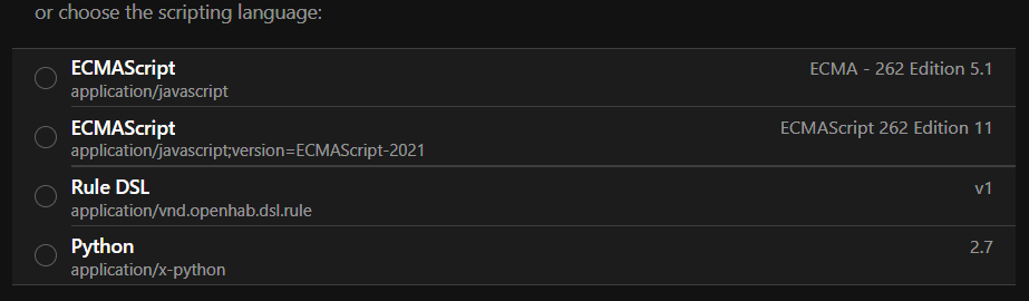

  1. Create a rule (mainUI) with ECMA 11, copy & paste the script.

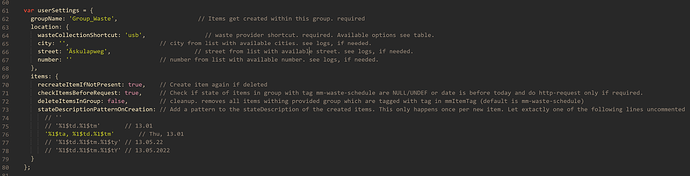

Get the shortcut for your region from the table in the script (usb in my example) and paste it into userSettings.location.wasteCollectionShortcut.
Paste the name of the group item into userSettings.groupName.
Script Settings

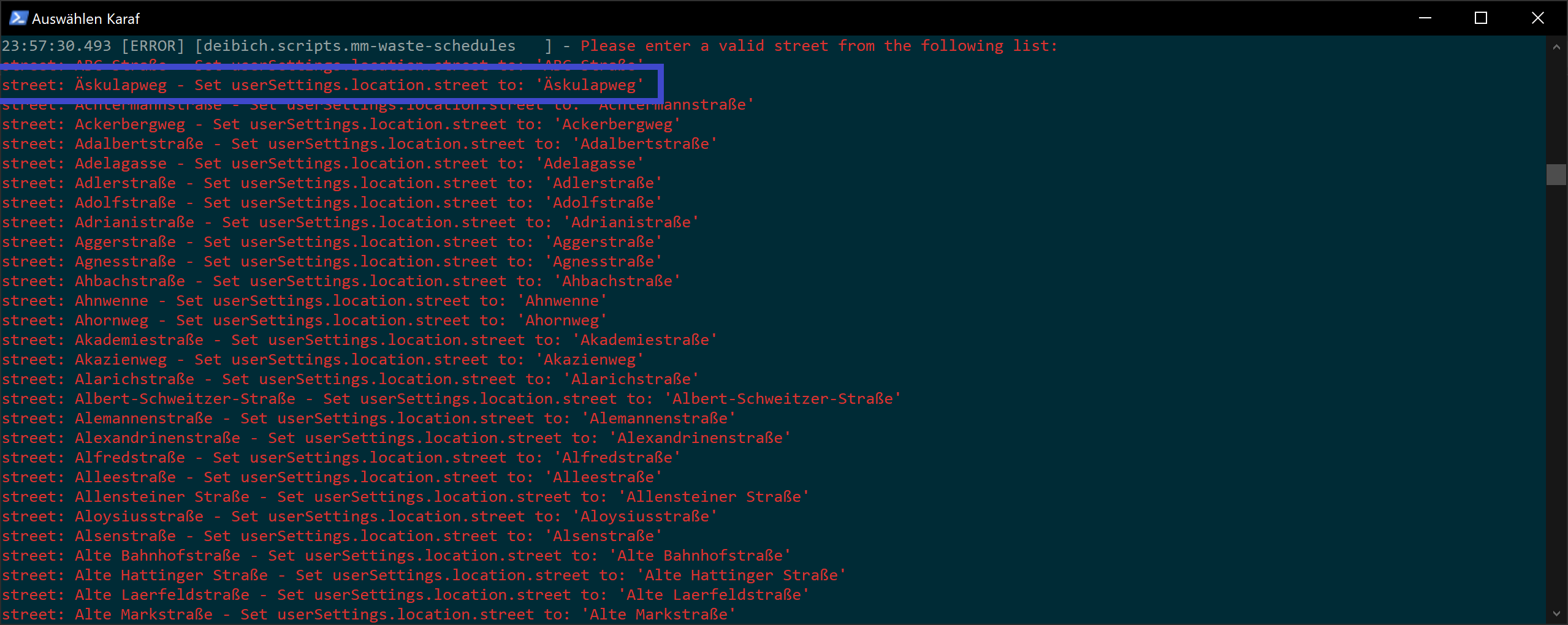

The log tells you what to do next.
Log Output
For my example i have to set userSettings.location.street to ‘Äskulapweg’.

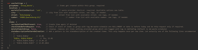

Script Settings
Save and run the rule again.

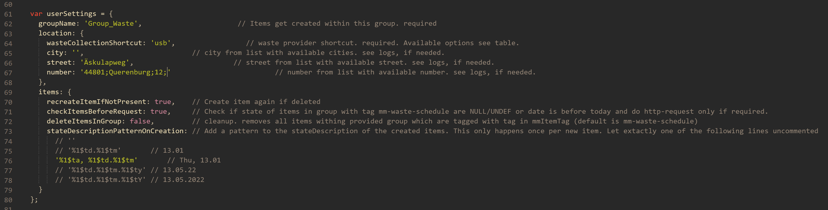

Now set userSettings.location.number to ‘44801;Querenburg;12;’
Script Settings

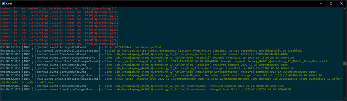

Save ad rund the rule again.
Log Output
The log should show that some items were created.

I can confirm this works with EVS. For some time I had the idea to realize this with Node RED, but never did. Thank you a lot for this OH-based solution!
One thing to mention: Logging does not work for me. But following your instructions, I now have two JS Script engines, so maybe or not I chose the wrong one. But as the script does its jobs, I don’t care. :wink:
[.internal.OpenhabGraalJSScriptEngine] - Failed to retrieve script script dependency listener from engine bindings. Script dependency tracking will be disabled.
Hey,
thank you for testing.
If you know your settings in advance and set them correct there is no output from the script unless you set deibich.scripts.mm-waste-schedules to a more verbose log level (debug or trace).
So the items are created and contain a timestamp, right?
The quoted warning can be ignored as far as I know.
Yes, all works fine.
