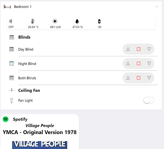

I took inspiration from with work on the UI Widget: Weather, specifically the card widget by @RGroll and @oh11. In particular their use of the Swiper component provided a good solution the screen size/resolution issues. Their solution was a great way to start learning the new UI.
Here is the result:

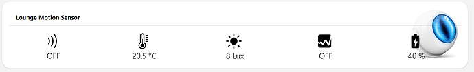

Large screen showing all items being displayed.

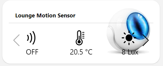

Small screen showing swiper functionality to access icons that don’t fit on screen.

  • In portrait mode on small screens swiping arrows overlap the buttons, requiring careful clicking (or the analyzer graphs are displayed for the icon. Not so easy with my fat fingers :stuck_out_tongue_winking_eye: Need to experiment with the swiper padding options.

Version 2, now supports any multi-sensor device with up to 7 different items/outputs. If the item is not populated in the widget properties, it is hidden from view. As standard:
  1. Motion sensor
  2. Door contact
  3. Temperature
  4. Light Intensity / UV
  5. Humidity
  6. Tamper
  7. Battery
Duplicate code has been removed and replaced with an oh-repeater:
          - component: oh-repeater
              sourceType: unset
              for: i
              in:
                - - item1
                  - warn1
                  - f7
                  - radiowaves_right
                - - item2
                  - warn2
                  - material
                  - sensor_door
                - - item3
                  - warn3

Also improved the layout so that the navigation arrows don’t overlap with the slider buttons.
Changed the UID to reflect the more generic nature of the widget.

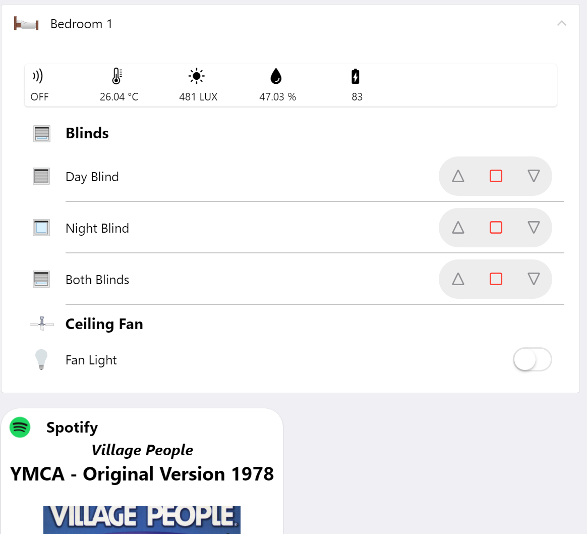

Very nice,
I will have to tweak my rip off version :blush:
I think one thing that might be worth a try is to make a version that assumes you have added equipment from the thing into the model including all of the points you want using default names. It would only be necessary then to set the equipment as all items would have names based on the equipment.
I think the challenge would be the zwave database would need to have consistent names for the equivalent endpoints for all supported devices so that it did not become very involved.
Based on your original (not latest) but only working for fibaro motion:
