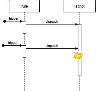

Crudely speaking, I’m assuming something like this is occuring then:
I have a rule that sets off a script, and that rule is then triggered before the script’s previous execution has completed, triggering the multi-threaded exception (because rules can run on different threads). I’m assuming providing the called script has completed the initial run, any timers are then synchronised, as otherwise the “reschedule if retriggered” concept wouldn’t work either?
I guess a work around here would be to use shared value cache to act as a monitor lock? With the rule checking for a lock, and either looping or simply not dispatching the script if it’s already running.

Thinking aloud a bit…
I’m taking from the error, the script is run on its own exclusive thread, if something else calls it from another thread, that’s where the problem occurs. It also seems that called scripts aren’t waited for, and are done in a fire and forget fashion - otherwise the queuing of rules you mention would deal with it.
Could, as a feature change, this be dealt with instead by using a producer/consumer pattern in the dispatch? The execution of a script can be dealt with sequentially by the consumer, which is also pinned to one thread.
Yes, with the understanding that a :script is a :rule and the problem will happen for any rule.
If I understand correctly, yes, access to a single Script Action/Condition’s context is synchronized so only one Thread can access it at a time. If the rule is running or a Timer is running, subsequent triggers or timers have to wait for access to the context.
But when a rule calls another rule that synchronization is bypassed.
I think at best that will reduce the number of occurrences of the exception but I’m not certain that everything that you have access to is synchronized in the ways that it needs to be. You’ll have TOCTOU problems I think.
You. can file an issue. But the challenge is this isn’t something that can be enforced in the JS Scripting add-on and this is not something that is a problem in any of the other rules languages. Should the other languages be limited in this way just because one of the half dozen rules languages has this problem? That’s going to be a hard sell.
