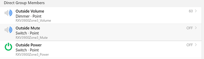

Im fully Ui - no item files - I dont think theres a way to get a text representation of them so will do screenshots:
“master” conrtrol - main power for Amp and two zone groups
“Main” zone (inside)
“Zone 3” (outside)

I can do it with multiple items to get waht i want but I am migrating my 2.5 to a new 3 OH instance and found I I can use the new Alexa metadata tags for a much tidier alexa with enpoints
