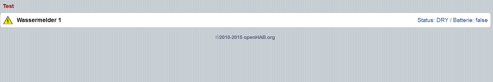

Hey guys,
i want to show the state and the batterystate of an water-detector in a single row.
My Result so far is:
I got a map for the battery_low (false=OK, true=Change Battery)
But i dont know how i transform the 0 from the battery. I want it to look like “Status: Dry / Batterie: OK”
Changing the False to 0 and true to 1 in the map doesnt help.
My Rule looks like this:
rule “allinone”
Item Wassermelder1_gW14_Serverraum received update or
Item Batterie_Wassermelder1_gW14_Serverraum received update or
System started
{ Allinone.postUpdate("Status: " + (Wassermelder1_gW14_Serverraum.state) + " / " +"Batterie: " + (Batterie_Wassermelder1_gW14_Serverraum.state))

@anfuchs Adapted the code as followed:
System started
Allinone.postUpdate(“Status: " + (Wassermelder1_gW14_Serverraum.state.format(”[MAP(Wassermelder.map):%s]")) + " / " +“Batterie: " + (Batterie_Wassermelder1_gW14_Serverraum.state.format(”[MAP(Battery.map):%s]")))
Result is unfortunately:
Maps are:
Wassermelder:
0=Trocken
1=Feuchtigkeit erkannt
2=Wasserstand erkannt
UNDEFINED=unbekannt
-=unbekannt
Batterie:
0=OK
1=Batterie wechseln!
-=unbekannt
UNDEFINED=unbekannt
Or do i still haven´t the right formatting?

[solved]
The else-if-thing worked, but only if i define the according item as a String. HM-WD seems to write the numbers automatically as Text if you define the item as a String. Bad side is i cant work with the status as a number for further operations.
Rule now looks like:
rule “allinone”
System started
if (Batterie_Wassermelder1_gW14_Serverraum.state == 0.00)
Allinone.postUpdate("Status: " + (Wassermelder1_gW14_Serverraum.state) + " / " +“Batterie: OK”)
else
Allinone.postUpdate("Status: " + (Wassermelder1_gW14_Serverraum.state) + " / " +"Batterie: Batterie wechseln! ")
Thanks for your help guys!
