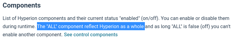

It seems the API was changed so that Hyperion general state is handled by special componnent called “ALL”:
Screenshot_20200611_180323
I am running modified binding now which seems to work, state changes are reflected in OH when toggled in Hyperion and no NPE:
Submitted PR for this issue:
