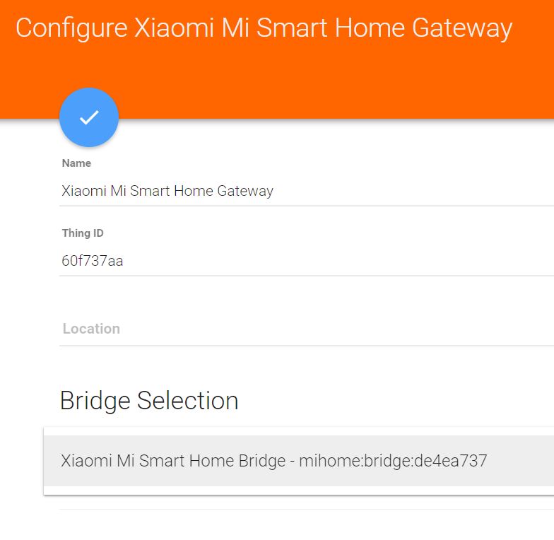

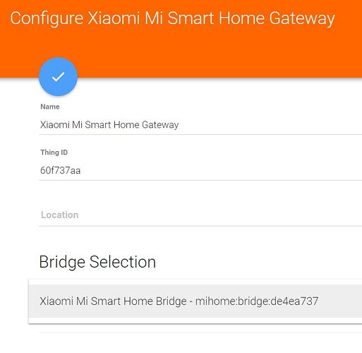

In my home setup I have two Xiaomi Gateways to cover connection. I can’t seem to add two gateways as bridges in openhab.
If I manual add another gateway I can only select the current bridge and not create a new one

The gateway is something else then the bridge. The gateway is a thing that can control the light and sound of the gateway that are on the same physical device that acts as the bridge for OH.
The bridge is the main element and should be defined first. Then you can add the gateway as first thing attached to the bridge
So your second Xiaomi device acts as second bridge. The gateway thing of the second device is attached to this second bridge

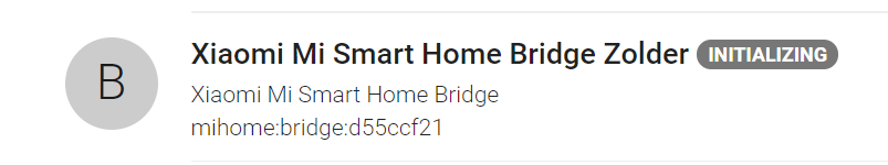

I’ve now added another Bridge, with correct IP and dev key. I’ve waited for a number of minutes but the Bridge is still in status Initializing.
I also added this Bridge as a single bridge to a clean instance and it changed to Online status in seconds. Any idea where this goes wrong?
Quick update after restarting OpenHab.
The second bridge is online, the first one is now on INITIALIAZING (and all devices of the first bridge are uninitialized). I also receive following error in the OpenHab Console
