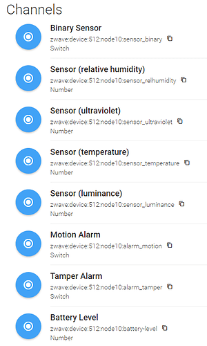

I don’t see the “Motion Alarm alarm_motion Door Switch” channel anywhere. Is this now called the “Alarm burglar” channel?

I’m on v1.8. I guess that’s new? Also, the motion channel isn’t showing at all, so what I might do it just reinstall all the Z-wave stuff, because there is no telling what I broke when I first started playing with it. Hopefully that fixes the problem there. Those links the cd-jackson are very useful.
