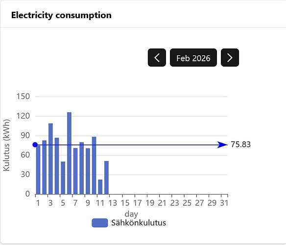

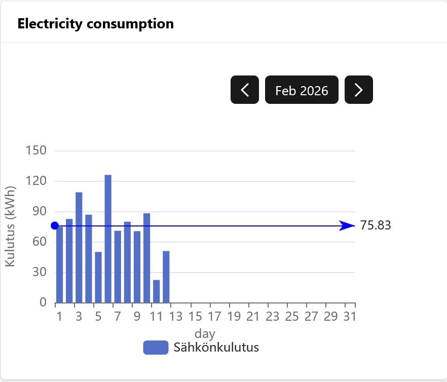

Last week I upgraded my OH5.1.1 under win11 to 5.1.2. Below is one chart example under 5.1.1. The chart shows my electricity consumption in Feb 2026. Both in 5.1.1 and 5.1.2 the left and right arrow buttons work so they both change the month by 1.

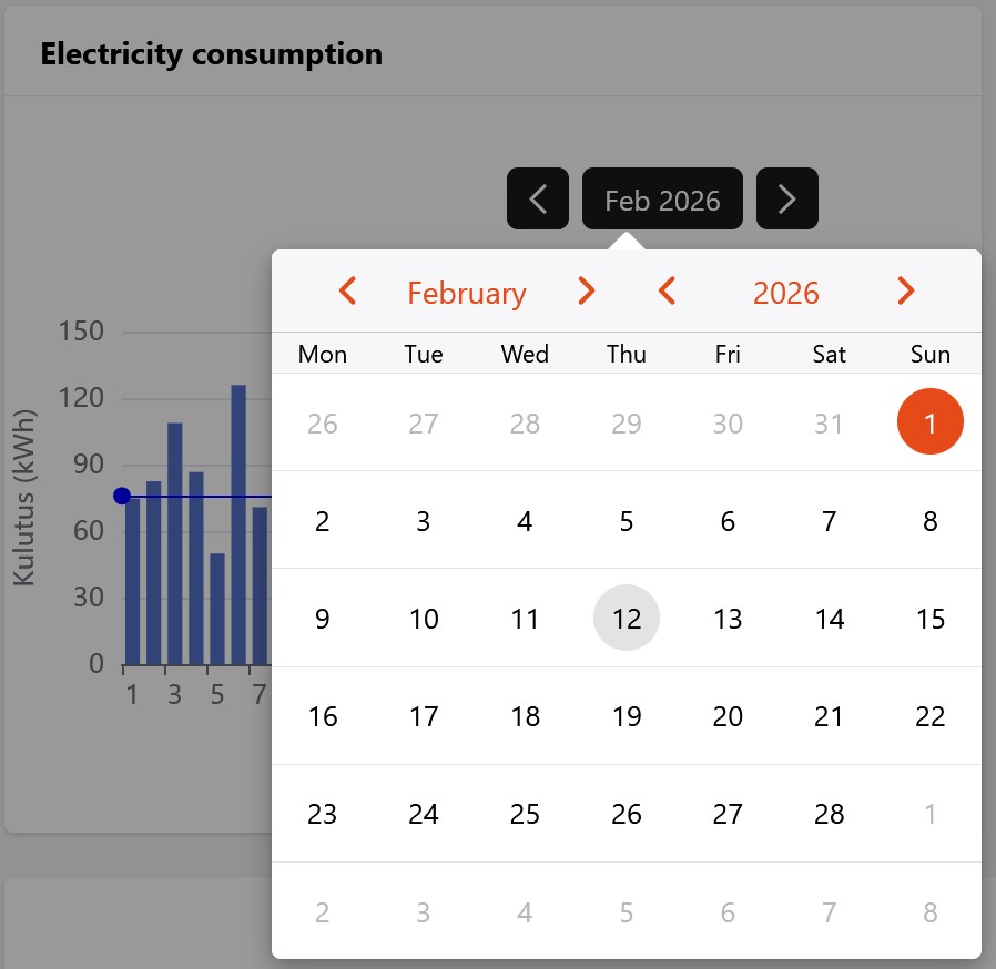

When I click on the Feb 2026 button, a calendar is opened (see the screenshot below).
I can then change the month and year by clicking the arrow buttons. In 5.1.1 when I click on any day the month/year are changed but in 5.1.2 nothing happens, i.e. the month is still Feb and year 2026. It seems that 5.1.2 broke this widget somehow. Below is the code for my widget:

Can you look at the web browser console to see if there are any warning/errors reported?
I can confirm this. Quickly tested in 5.2.M1 with chart type e.g. fixed to month.
I don’t think the issue is the widget. It is a bug in the charts. Can you open an issue on Github?
I had a look at the console but didn’t see any errors there.
Many thanks for testing with a chart. I have now created an issue in Github.
This issue has now ben fixed in 5.1.3. Many thanks!
