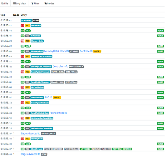

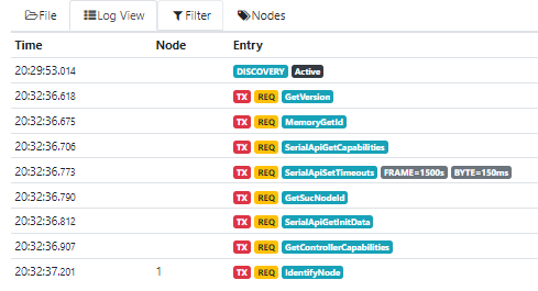

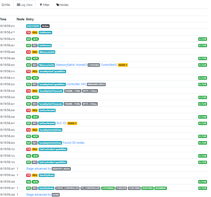

Welcome to OH forum. Sorry first post is a problem. Worse, I’m not sure what is going on, except that the controller is not responding to messages (TX).
There is a debug log viewer here. and your snippet shows is
what it should look like is this.
My guess is that it has something to do with Docker. Have you reviewed the Docker installation regarding USB devices? Look at the bottom of the docs. Docker | openHAB an 800 stick is usually /dev/ttyUSB0, but as noted it could be different.
