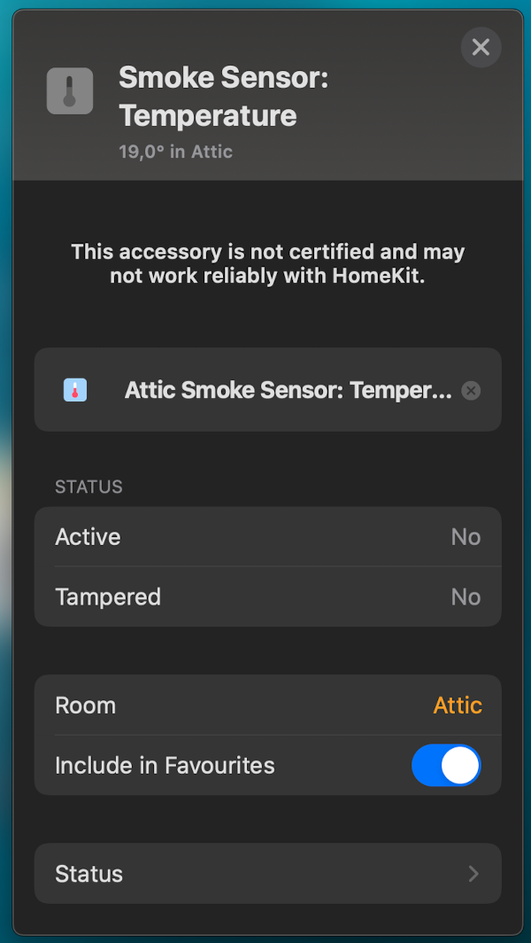

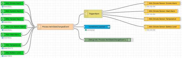

Here’s how I turned the Fibaro FGSD-002 Smoke Sensor into an HomeKit accessory.
The flow itself:

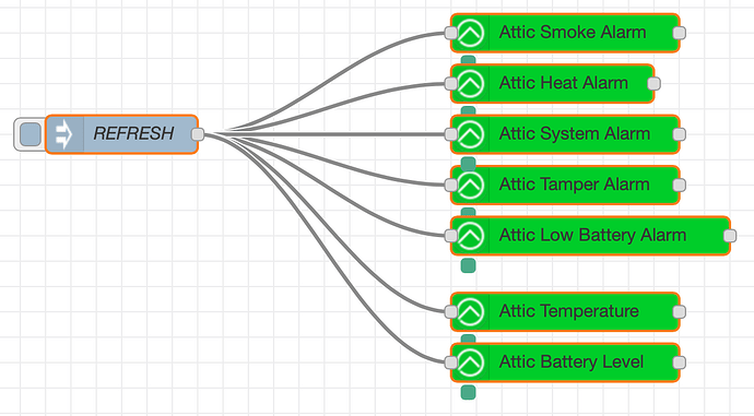

And the REFRESH sub flow:

      "id":"9b6dd772.ce8938",
      "type":"inject",
      "z":"5aea18b7.bbc2f8",
      "name":"REFRESH",
      "topic":"",
      "payload":"REFRESH",
      "payloadType":"str",
      "repeat":"",
      "crontab":"",
      "once":false,
      "onceDelay":0.1,
      "x":140,
      "y":1180,
      "wires":[
            "319e28f1.69b708",
            "7ebfc29a.7266ac",
            "14ba4155.348197",
            "92ee5ecb.0f69c8",
            "d2d1e2cd.7632d8",
            "18e0d6dd.710ae1",
            "aa19a46d.93e24"

So far the main problem I have, is that the temperature sensor is always set to inactive :frowning:
Also, and this seems to be a limitation of the Home app, temperatures are always rounded to a full degree.
I managed to find a solution.
Meanwhile I rewrote the flow to make it more readable.
The logic resides in Process ItemStateChangedEvent which I wired to the raw event port (2nd output) of the leftmost openHAB item nodes:
// Only process ItemStateChangedEvent (contains old and new state)
SMOKE_ALARM = " SmokeAlarm "
HEAT_ALARM = " HeatAlarm "
TEMPERATURE = " Temperature "
BATTERY = " Battery "
/* Telegram emoji (HTML codes): */
EMOJI_alarm = "⚠️"
EMOJI_fire = "🔥"
EMOJI_battery = "🔋"
EMOJI_thermometer = "🌡️"
EMOJI_ok_button = "🆗"
EMOJI_green_circle = "🟢"
EMOJI_yellow_circle = "🟡"
EMOJI_orange_circle = "🟠"
EMOJI_red_circle = "🔴"
EMOJI_hot_springs = "♨️"
EMOJI_siren = "🚨"
EMOJI_gear = "⚙️"
if (msg.payload.type == "ItemStateChangedEvent") {
    x = msg.item.split("_SmokeAlarm_")
    item_id = x[0]
    event_id = x[1]
    oldState = msg.payload.payload.oldValue
    newState = msg.payload.payload.value
    node.log("[Process ItemStateChangedEvent] - (OK - 1) message item: " + JSON.stringify(msg.item))
    node.log("[Process ItemStateChangedEvent] - (OK - 2) message payload: " + JSON.stringify(msg.payload))
    node.log("[Process ItemStateChangedEvent] - (OK - 3) - " + item_id + " (" + event_id + ") - state changed from '" + oldState + "' to '" + newState + "'")
    // Homekit Accessory Protocol message:
    hapMsg = {
        topic: msg.payload.topic,
        item: msg.item,
        type: msg.payload.type,
        target: {},
        payload: {}
    // Telegram message (HTML)
    telegramMsg = {
        method: "sendMessage",
        payload: {
            parse_mode: "HTML",
            text: "<b>" + event_id + " for " + msg.item + "</b> (was '" + oldState + "', is now '" + newState + "')"
    isOk = false
    sendTelegram = false
    val = null
    isActive = null
    switch(event_id) {
        case "Alarm_Smoke":
            alarm_type = "Smoke"
            if (newState == "ON") {
                val = 1
                telegramMsg.payload.text = EMOJI_alarm + " [" + EMOJI_fire + "<b>" + alarm_type + " Alarm</b>] triggered for <b>" + item_id + "</b>: Please check!"
                sendTelegram = true
            } else {
                val = 0
                // Only send a Telegram message if the old state was "ON" (not "NULL")
                if (oldState == "ON") {
                    telegramMsg.payload.text = EMOJI_green_circle + " [" + EMOJI_fire + "<b>" + alarm_type + " Alarm</b>] for <b>" + item_id + "</b> has been disarmed."
                    sendTelegram = true
            hapMsg.target = SMOKE_ALARM
            hapMsg.payload = { "SmokeDetected": val }
            isOk = true
            break;
        case "Alarm_Heat":
            alarm_type = "Heat"
                val = 1
                telegramMsg.payload.text = EMOJI_alarm + " [" + EMOJI_hot_springs + "<b>" + alarm_type + " Alarm</b>] triggered for <b>" + item_id + "</b>: Please check!"
                sendTelegram = true
            } else {
                val = 0
                    telegramMsg.payload.text = EMOJI_green_circle + " [" + EMOJI_hot_springs + "<b>" + alarm_type + " Alarm</b>] for <b>" + item_id + "</b> has been disarmed."
                    sendTelegram = true
            // TODO: replace SmokeDetected with 'HeatDetected' when available in HomeKit HAP
            hapMsg.target = HEAT_ALARM
            isOk = true
            break;
        case "Alarm_Tamper":
            alarm_type = "Tamper"
                val = 1
                telegramMsg.payload.text = EMOJI_alarm + " [" + EMOJI_siren + "<b>" + alarm_type + " Alarm</b>] triggered for <b>" + item_id + "</b>: Please check!"
                sendTelegram = true
            } else {
                val = 0
                    telegramMsg.payload.text = EMOJI_green_circle + " [" + EMOJI_siren + "<b>" + alarm_type + " Alarm</b>] for <b>" + item_id + "</b> has been disarmed."
                    sendTelegram = true
            hapMsg.target = SMOKE_ALARM + HEAT_ALARM + TEMPERATURE
            hapMsg.payload = { "StatusTampered": val }
            isOk = true
            break;
        case "Alarm_Battery":
            alarm_type = "Battery Low"
                val = 1
                telegramMsg.payload.text = EMOJI_alarm + " [" + EMOJI_battery + "<b>" + alarm_type + " Alarm</b>] triggered for <b>" + item_id + "</b>: Please check!"
                sendTelegram = true
            } else {
                val = 0
                    telegramMsg.payload.text = EMOJI_green_circle + " [" + EMOJI_battery + "<b>" + alarm_type + " Alarm</b>] for <b>" + item_id + "</b> has been disarmed."
                    sendTelegram = true
            hapMsg.payload = { "StatusLowBattery": val }
            isOk = true
            break;
        case "Alarm_System":
            alarm_type = "System"
                val = 1
                isActive = false
                telegramMsg.payload.text = EMOJI_alarm + " [" + EMOJI_gear + "<b>" + alarm_type + " Alarm</b>] triggered for <b>" + item_id + "</b>: Smoke Alarm Unit Defective: Please check!"
                sendTelegram = true
            } else {
                val = 0
                isActive = true
                    telegramMsg.payload.text = EMOJI_green_circle + " [" + EMOJI_gear + "<b>" + alarm_type + " Alarm</b>] for <b>" + item_id + "</b> has been disarmed."
                    sendTelegram = true
            hapMsg.payload = {
                "StatusFault": val,
                "StatusActive": isActive
            isOk = true
            break;
        case "Temperature":
            currentTemp = parseFloat(newState.split(" ")[0])
            if (! isNaN(currentTemp)) {
                hapMsg.target = TEMPERATURE
                hapMsg.payload = { "CurrentTemperature": currentTemp }
                isOk = true
            break;
        case "Battery":
            currentLevel = parseFloat(newState)
            if (! isNaN(currentLevel)) {
                hapMsg.target = BATTERY // SMOKE_ALARM + HEAT_ALARM + TEMPERATURE
                hapMsg.payload = { "BatteryLevel": currentLevel }
                isOk = true
            break;
    // First return the HAP message, then the Telegram message, finally the original StateChangedEvent message (for debugging / logging)
    if (isOk === true) {
        return [hapMsg, (sendTelegram === true ? telegramMsg : null), msg];
} /* else {
    node.warn("Unexpected event type for message: " + JSON.stringify(msg))
The output is then wired to the TriggerAlarm switch and routes the messages to the 4 HAP nodes, depending on the value of HAPmsg.target.
Here’s the full code of the flow:
      "id":"f3617abd.d3d688",
      "type":"openhab2-in",
      "name":"Attic Smoke Alarm",
      "controller":"f6e63178.0817a8",
      "itemname":"AT_Attic_SmokeAlarm_Alarm_Smoke",
      "x":130,
      "y":140,
      "wires":[
            "f9d062b8.4e159"
      "id":"dc115a03.f7d6b",
      "type":"homekit-service",
      "isParent":true,
      "bridge":"27a289cc.9765c6",
      "accessoryCategory":"OTHER",
      "parentService":"",
      "name":"Attic Smoke Sensor: Smoke Alarm",
      "serviceName":"SmokeSensor",
      "topic":"",
      "filter":false,
      "manufacturer":"Fibaro",
      "model":"FGSD-002 ZW5 v3.3",
      "serialNo":"000 000 294 265",
      "cameraConfigVideoProcessor":"ffmpeg",
      "cameraConfigSource":"",
      "cameraConfigStillImageSource":"",
      "cameraConfigMaxStreams":2,
      "cameraConfigMaxWidth":1280,
      "cameraConfigMaxHeight":720,
      "cameraConfigMaxFPS":10,
      "cameraConfigMaxBitrate":300,
      "cameraConfigVideoCodec":"libx264",
      "cameraConfigAudioCodec":"libfdk_aac",
      "cameraConfigAudio":false,
      "cameraConfigPacketSize":1316,
      "cameraConfigVerticalFlip":false,
      "cameraConfigHorizontalFlip":false,
      "cameraConfigMapVideo":"0:0",
      "cameraConfigMapAudio":"0:1",
      "cameraConfigVideoFilter":"scale=1280:720",
      "cameraConfigAdditionalCommandLine":"-tune zerolatency",
      "cameraConfigDebug":false,
      "cameraConfigSnapshotOutput":"disabled",
      "characteristicProperties":"{\n    \"StatusActive\": true,\n    \"StatusTampered\": false,\n    \"StatusFault\": false,\n    \"StatusLowBattery\": false\n}",
      "x":1280,
      "y":140,
      "wires":[
      "id":"8e6231e8.7e1638",
      "name":"Attic Heat Alarm",
      "itemname":"AT_Attic_SmokeAlarm_Alarm_Heat",
      "x":120,
      "y":380,
      "wires":[
            "f9d062b8.4e159"
      "id":"352eef0.4c31c12",
      "isParent":true,
      "accessoryCategory":"SENSOR",
      "parentService":"",
      "name":"Attic Smoke Sensor: Heat Alarm",
      "topic":"",
      "filter":false,
      "x":1270,
      "y":200,
      "wires":[
      "id":"d4ece5ea.7ff4d",
      "name":"Attic Tamper Alarm",
      "itemname":"AT_Attic_SmokeAlarm_Alarm_Tamper",
      "x":130,
      "y":260,
      "wires":[
            "f9d062b8.4e159"
      "id":"6c1373d1.96e414",
      "name":"Attic Low Battery Alarm",
      "itemname":"AT_Attic_SmokeAlarm_Alarm_Battery",
      "x":140,
      "y":320,
      "wires":[
            "f9d062b8.4e159"
      "id":"f3ad8597.d4a4f8",
      "name":"Attic Temperature",
      "itemname":"AT_Attic_SmokeAlarm_Temperature",
      "x":120,
      "y":460,
      "wires":[
            "f9d062b8.4e159"
      "id":"4a076e7d.21753",
      "isParent":true,
      "parentService":"",
      "name":"Attic Smoke Sensor: Temperature",
      "serviceName":"TemperatureSensor",
      "topic":"",
      "filter":false,
      "characteristicProperties":"{\n    \"StatusActive\": true,\n    \"StatusTampered\": false,\n    \"StatusFault\": false,\n    \"StatusLowBattery\": false,\n    \"CurrentTemperature\": 0.0\n}",
      "x":1280,
      "y":260,
      "wires":[
      "id":"e377c7d6.32b518",
      "name":"Attic Battery Level",
      "itemname":"AT_Attic_SmokeAlarm_Battery",
      "x":130,
      "y":520,
      "wires":[
            "f9d062b8.4e159"
      "id":"75914009.6daf58",
      "name":"Attic System Alarm",
      "itemname":"AT_Attic_SmokeAlarm_Alarm_System",
      "x":130,
      "y":200,
      "wires":[
            "f9d062b8.4e159"
      "id":"14b05210.9b7b0e",
      "isParent":false,
      "parentService":"4a076e7d.21753",
      "name":"Attic Smoke Sensor: Battery Level",
      "serviceName":"BatteryService",
      "topic":"",
      "filter":false,
      "characteristicProperties":"{\n    \"ChargingState\": 2\n}",
      "x":1280,
      "y":320,
      "wires":[
      "id":"741030fc.43dd58",
      "type":"telegrambot-payload",
      "name":"homebrainz payload",
      "bot":"d9273cbd.1fd778",
      "chatId":"858292107",
      "sendMethod":"",
      "payload":"",
      "x":780,
      "y":320,
      "wires":[
      "id":"630909b.41afef8",
      "type":"debug",
      "name":"Debug info: Process ItemStateChangeEvent",
      "active":false,
      "tosidebar":true,
      "console":true,
      "tostatus":false,
      "complete":"true",
      "targetType":"full",
      "x":860,
      "y":420,
      "wires":[
      "id":"f9d062b8.4e159",
      "type":"function",
      "name":"Process ItemStateChangedEvent",
      "func":"// Only process ItemStateChangedEvent (contains old and new state)\nSMOKE_ALARM = \" SmokeAlarm \"\nHEAT_ALARM = \" HeatAlarm \"\nTEMPERATURE = \" Temperature \"\nBATTERY = \" Battery \"\n\n/* Telegram emoji (HTML codes): */\nEMOJI_alarm = \"&#9888;&#65039;\"\nEMOJI_fire = \"&#x1f525;\"\nEMOJI_battery = \"&#128267;\"\nEMOJI_thermometer = \"&#127777;&#65039;\"\nEMOJI_ok_button = \"&#127383;\"\nEMOJI_green_circle = \"&#128994;\"\nEMOJI_yellow_circle = \"&#128993;\"\nEMOJI_orange_circle = \"&#128992;\"\nEMOJI_red_circle = \"&#128308;\"\nEMOJI_hot_springs = \"&#9832;&#65039;\"\nEMOJI_siren = \"&#128680;\"\nEMOJI_gear = \"&#9881;&#65039;\"\n\n/*\nnode.log(\"[Process ItemStateChangedEvent] - (1) message: \" + JSON.stringify(msg))\nnode.log(\"[Process ItemStateChangedEvent] - (2) message payload: \" + JSON.stringify(msg.payload))\nnode.log(\"[Process ItemStateChangedEvent] - (3) message payload type: \" + JSON.stringify(msg.payload.type))\n*/\n\nif (msg.payload.type == \"ItemStateChangedEvent\") {\n\n    x = msg.item.split(\"_SmokeAlarm_\")\n    item_id = x[0]\n    event_id = x[1]\n\n    oldState = msg.payload.payload.oldValue\n    newState = msg.payload.payload.value\n\n    node.log(\"[Process ItemStateChangedEvent] - (OK - 1) message item: \" + JSON.stringify(msg.item))\n    node.log(\"[Process ItemStateChangedEvent] - (OK - 2) message payload: \" + JSON.stringify(msg.payload))\n    node.log(\"[Process ItemStateChangedEvent] - (OK - 3) - \" + item_id + \" (\" + event_id + \") - state changed from '\" + oldState + \"' to '\" + newState + \"'\")\n    \n    // Homekit Accessory Protocol message:\n    hapMsg = {\n        topic: msg.payload.topic,\n        item: msg.item,\n        type: msg.payload.type,\n        target: {},\n        payload: {}\n    }\n    \n    // Telegram message (HTML) // fire emoji :== \"\\xF0\\x9F\\x94\\xA5\"\n    telegramMsg = {\n        method: \"sendMessage\",\n        payload: {\n            parse_mode: \"HTML\",\n            text: \"<b>\" + event_id + \" for \" + msg.item + \"</b> (was '\" + oldState + \"', is now '\" + newState + \"')\"\n        }\n    }\n    \n    isOk = false\n    sendTelegram = false\n    val = null\n    isActive = null\n    \n    switch(event_id) {\n        case \"Alarm_Smoke\":\n            alarm_type = \"Smoke\"\n            if (newState == \"ON\") {\n                val = 1\n                telegramMsg.payload.text = EMOJI_alarm + \" [\" + EMOJI_fire + \"<b>\" + alarm_type + \" Alarm</b>] triggered for <b>\" + item_id + \"</b>: Please check!\"\n                sendTelegram = true\n            } else {\n                val = 0\n                // Only send a Telegram message if the old state was \"ON\" (not \"NULL\")\n                if (oldState == \"ON\") {\n                    telegramMsg.payload.text = EMOJI_green_circle + \" [\" + EMOJI_fire + \"<b>\" + alarm_type + \" Alarm</b>] for <b>\" + item_id + \"</b> has been disarmed.\"\n                    sendTelegram = true\n                }\n            }\n            hapMsg.target = SMOKE_ALARM\n            hapMsg.payload = { \"SmokeDetected\": val }\n            isOk = true\n            break;\n    \n        case \"Alarm_Heat\":\n            alarm_type = \"Heat\"\n            if (newState == \"ON\") {\n                val = 1\n                telegramMsg.payload.text = EMOJI_alarm + \" [\" + EMOJI_hot_springs + \"<b>\" + alarm_type + \" Alarm</b>] triggered for <b>\" + item_id + \"</b>: Please check!\"\n                sendTelegram = true\n            } else {\n                val = 0\n                // Only send a Telegram message if the old state was \"ON\" (not \"NULL\")\n                if (oldState == \"ON\") {\n                    telegramMsg.payload.text = EMOJI_green_circle + \" [\" + EMOJI_hot_springs + \"<b>\" + alarm_type + \" Alarm</b>] for <b>\" + item_id + \"</b> has been disarmed.\"\n                    sendTelegram = true\n                }\n            }\n            // TODO: replace SmokeDetected with 'HeatDetected' when available\n            hapMsg.target = HEAT_ALARM\n            hapMsg.payload = { \"SmokeDetected\": val }\n            isOk = true\n            break;\n    \n        case \"Alarm_Tamper\":\n            alarm_type = \"Tamper\"\n            if (newState == \"ON\") {\n                val = 1\n                telegramMsg.payload.text = EMOJI_alarm + \" [\" + EMOJI_siren + \"<b>\" + alarm_type + \" Alarm</b>] triggered for <b>\" + item_id + \"</b>: Please check!\"\n                sendTelegram = true\n            } else {\n                val = 0\n                // Only send a Telegram message if the old state was \"ON\" (not \"NULL\")\n                if (oldState == \"ON\") {\n                    telegramMsg.payload.text = EMOJI_green_circle + \" [\" + EMOJI_siren + \"<b>\" + alarm_type + \" Alarm</b>] for <b>\" + item_id + \"</b> has been disarmed.\"\n                    sendTelegram = true\n                }\n            }\n            hapMsg.target = SMOKE_ALARM + HEAT_ALARM + TEMPERATURE\n            hapMsg.payload = { \"StatusTampered\": val }\n            isOk = true\n            break;\n    \n        case \"Alarm_Battery\":\n            alarm_type = \"Battery Low\"\n            if (newState == \"ON\") {\n                val = 1\n                telegramMsg.payload.text = EMOJI_alarm + \" [\" + EMOJI_battery + \"<b>\" + alarm_type + \" Alarm</b>] triggered for <b>\" + item_id + \"</b>: Please check!\"\n                sendTelegram = true\n            } else {\n                val = 0\n                // Only send a Telegram message if the old state was \"ON\" (not \"NULL\")\n                if (oldState == \"ON\") {\n                    telegramMsg.payload.text = EMOJI_green_circle + \" [\" + EMOJI_battery + \"<b>\" + alarm_type + \" Alarm</b>] for <b>\" + item_id + \"</b> has been disarmed.\"\n                    sendTelegram = true\n                }\n            }\n            hapMsg.target = SMOKE_ALARM + HEAT_ALARM + TEMPERATURE\n            hapMsg.payload = { \"StatusLowBattery\": val }\n            isOk = true\n            break;\n    \n        case \"Alarm_System\":\n            alarm_type = \"System\"\n            if (newState == \"ON\") {\n                val = 1\n                isActive = false\n                telegramMsg.payload.text = EMOJI_alarm + \" [\" + EMOJI_gear + \"<b>\" + alarm_type + \" Alarm</b>] triggered for <b>\" + item_id + \"</b>: Smoke Alarm Unit Defective: Please check!\"\n                sendTelegram = true\n            } else {\n                val = 0\n                isActive = true\n                // Only send a Telegram message if the old state was \"ON\" (not \"NULL\")\n                if (oldState == \"ON\") {\n                    telegramMsg.payload.text = EMOJI_green_circle + \" [\" + EMOJI_gear + \"<b>\" + alarm_type + \" Alarm</b>] for <b>\" + item_id + \"</b> has been disarmed.\"\n                    sendTelegram = true\n                }\n            }\n            hapMsg.target = SMOKE_ALARM + HEAT_ALARM + TEMPERATURE\n            hapMsg.payload = {\n                \"StatusFault\": val,\n                \"StatusActive\": isActive\n            }\n            isOk = true\n            break;\n            \n        case \"Temperature\":\n            currentTemp = parseFloat(newState.split(\" \")[0])\n\n            if (! isNaN(currentTemp)) {\n                hapMsg.target = TEMPERATURE\n                hapMsg.payload = { \"CurrentTemperature\": currentTemp }\n                isOk = true\n            }\n            break;\n    \n        case \"Battery\":\n            currentLevel = parseFloat(newState)\n            \n            if (! isNaN(currentLevel)) {\n                hapMsg.target = BATTERY // SMOKE_ALARM + HEAT_ALARM + TEMPERATURE\n                hapMsg.payload = { \"BatteryLevel\": currentLevel }\n                isOk = true\n            }\n            break;\n    \n    }\n\n    // First return the HAP message, then the Telegram message, finally the original StateChangedEvent message (for debugging / logging)\n    if (isOk === true) {\n        return [hapMsg, (sendTelegram === true ? telegramMsg : null), msg];\n    }\n} /* else {\n    node.warn(\"Unexpected event type for message: \" + JSON.stringify(msg))\n} */",
      "outputs":3,
      "noerr":0,
      "x":460,
      "y":320,
      "wires":[
            "3c891b83.70038c"
            "741030fc.43dd58"
            "630909b.41afef8"
      "id":"3c891b83.70038c",
      "type":"switch",
      "name":"TriggerAlarm",
      "property":"msg.target",
      "propertyType":"jsonata",
      "rules":[
            "t":"cont",
            "v":"SmokeAlarm",
            "vt":"str"
            "t":"cont",
            "v":"HeatAlarm",
            "vt":"str"
            "t":"cont",
            "v":"Temperature",
            "vt":"str"
            "t":"cont",
            "v":"Battery",
            "vt":"str"
      "checkall":"true",
      "repair":false,
      "outputs":4,
      "x":750,
      "y":220,
      "wires":[
            "dc115a03.f7d6b"
            "352eef0.4c31c12"
            "4a076e7d.21753"
            "14b05210.9b7b0e"
      "id":"f6e63178.0817a8",
      "type":"openhab2-controller",
      "z":"",
      "name":"OH2 RPi3",
      "protocol":"http",
      "host":"localhost",
      "port":"8080",
      "path":"",
      "username":"",
      "password":""
      "id":"27a289cc.9765c6",
      "type":"homekit-bridge",
      "z":"",
      "bridgeName":"openHAB2",
      "pinCode":"031-45-154",
      "port":"",
      "allowInsecureRequest":false,
      "manufacturer":"openHAB",
      "model":"RPi3B+",
      "serialNo":"Default Serial Number",
      "customMdnsConfig":false,
      "mdnsMulticast":true,
      "mdnsInterface":"",
      "mdnsPort":"",
      "mdnsIp":"",
      "mdnsTtl":"",
      "mdnsLoopback":true,
      "mdnsReuseAddr":true,
      "allowMessagePassthrough":true
      "id":"d9273cbd.1fd778",
      "type":"telegrambot-config",
      "z":"",
      "botname":"homebrainz",
      "usernames":"",
      "chatIds":"858292107",
      "pollInterval":"300"
The items are defined as follows:
Group gSmokeAlarms
// Attic smoke alarm: Fibaro FGSD-002 ZW5 v3.3 smoke and heat sensor
Group AT_Attic_SmokeAlarm (gSmokeAlarms)
Number:Temperature AT_Attic_SmokeAlarm_Temperature "Attic Temperature [%.1f %unit%]" <temperature> (AT_Attic_SmokeAlarm, gHome_AT_Attic, gPersist_everyChange) {
    channel="zwave:device:controller:node13:sensor_temperature"
Switch             AT_Attic_SmokeAlarm_Alarm_Heat    "Heat alarm"       <alarm> (AT_Attic_SmokeAlarm, gHome_AT_Attic, gPersist_everyChange) {
    channel="zwave:device:controller:node13:alarm_heat"
Switch             AT_Attic_SmokeAlarm_Alarm_Smoke   "Smoke alarm"      <alarm> (AT_Attic_SmokeAlarm, gHome_AT_Attic, gPersist_everyChange) {
    channel="zwave:device:controller:node13:alarm_smoke"
Switch             AT_Attic_SmokeAlarm_Alarm_System   "Hardware failure alarm"      <alarm> (AT_Attic_SmokeAlarm, gHome_AT_Attic, gPersist_everyChange) {
    channel="zwave:device:controller:node13:alarm_system"
Switch             AT_Attic_SmokeAlarm_Alarm_Tamper   "Tamper alarm"      <alarm> (AT_Attic_SmokeAlarm, gHome_AT_Attic, gPersist_everyChange) {
    channel="zwave:device:controller:node13:alarm_tamper"
Switch             AT_Attic_SmokeAlarm_Alarm_Battery   "Battery Low"      <lowbattery> (AT_Attic_SmokeAlarm, gHome_AT_Attic, gPersist_everyChange, gBatteryLow) {
    channel="zwave:device:controller:node13:alarm_battery"
Number              AT_Attic_SmokeAlarm_Battery        "Attic Smoke Alarm: Battery Level [%.1f %%]" <battery>     (AT_Attic_SmokeAlarm, gHome_AT_Attic, gPersist_everyChange, gBattery, gBatteryLevel, gBatteryType_CR123A) {
    channel="zwave:device:controller:node13:battery-level"
