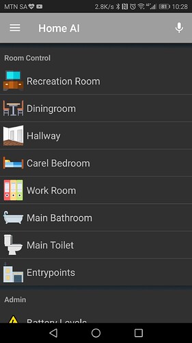

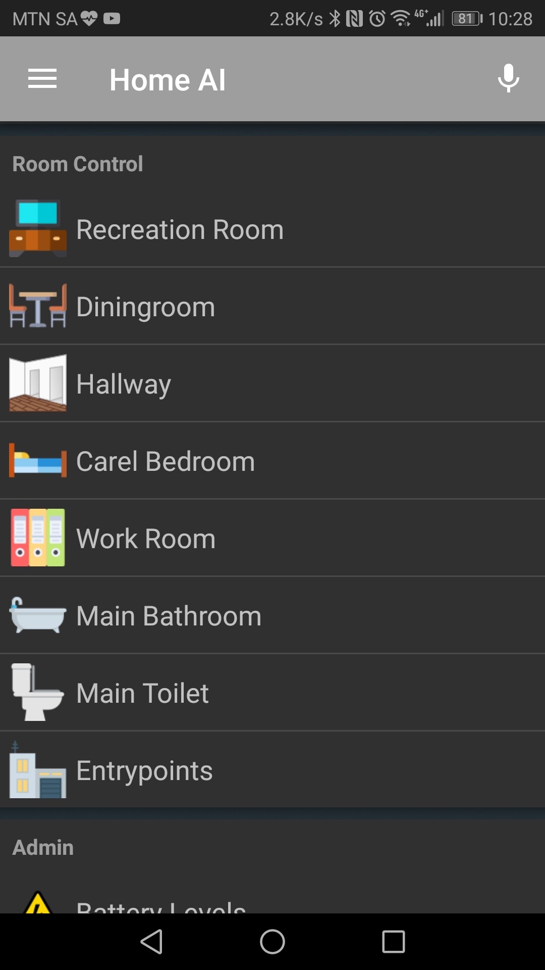

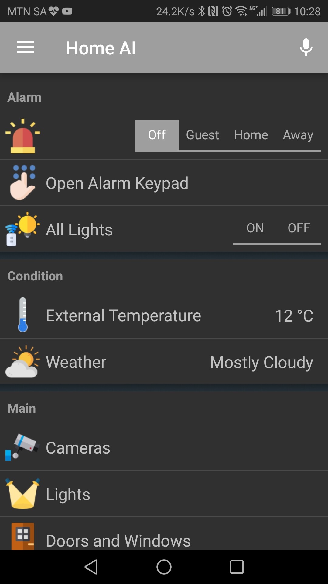

Few cool things I am doing with my Basic UI (not very impressive, but cool nonetheless).
  • I added a bunch of custom icons, and also implemented using the Weather Underground weather conditions icons to update on Basic UI. Works great for the most part.
  • I change the Temp icon depending on whether it is hot or cold. Also works great.
  • I use the visibility attribute to show certain important information at the top of the Basic UI menu when applicable, for example, if humidity goes over 95%, or the wind speed is very high, it will display it in the front UI.
  • I also use this for displaying when my gate or garage is open.

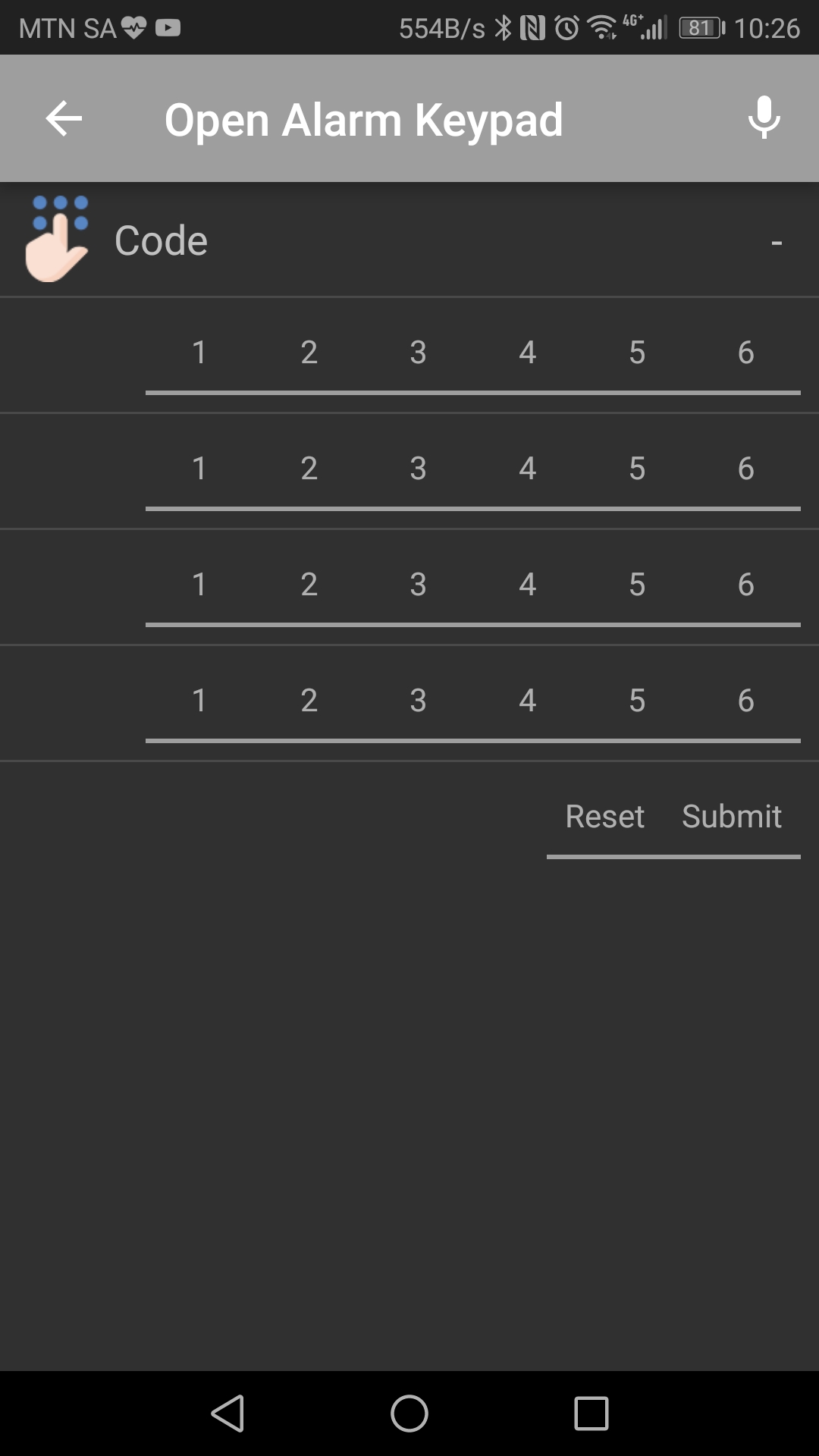

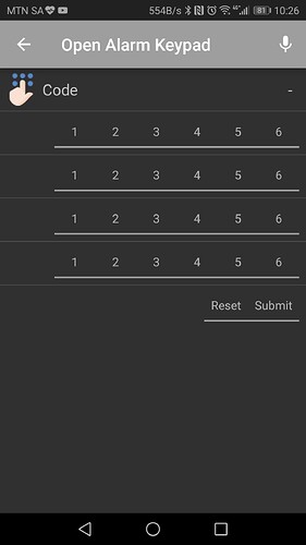

Another thing I’m working on now is an alarm. I can arm the alarm using switches, and also have it trigger and play the “Alarm Sound” on my Xiaomi Gateways. Unfortunately, at the moment the ability to upload custom sound effects to the Gateways appears to be disabled. So I can’t upload a proper alarm sound effect, which is somewhat annoying.
I also tried to implement a Alarm Code entry using a bunch of switches that update a String field, and use this to disarm the alarm.
But there is a slight delay using this method, (because it has to update the state of each ‘line’ of numbers) so to quickly and accurately type in the code is somewhat hard.
This, and the fact that I cannot upload an alarm sound right now to the Gateway, has paused this part of my project for now.

One quick question, how did you arm the alarm via openhab?
Cheers,
Pim
I have to mention when I say alarm, I just mean an internal alarm using openHAB (using various sensors I have everywhere). So I don’t actually currently have a connection to an existing external alarm, still working on that one.
So this arming is simply a mapped Number item with 4 states (Off, Home, Guest, Away), with sensors triggering an alarm state depending on the Alarm value.
