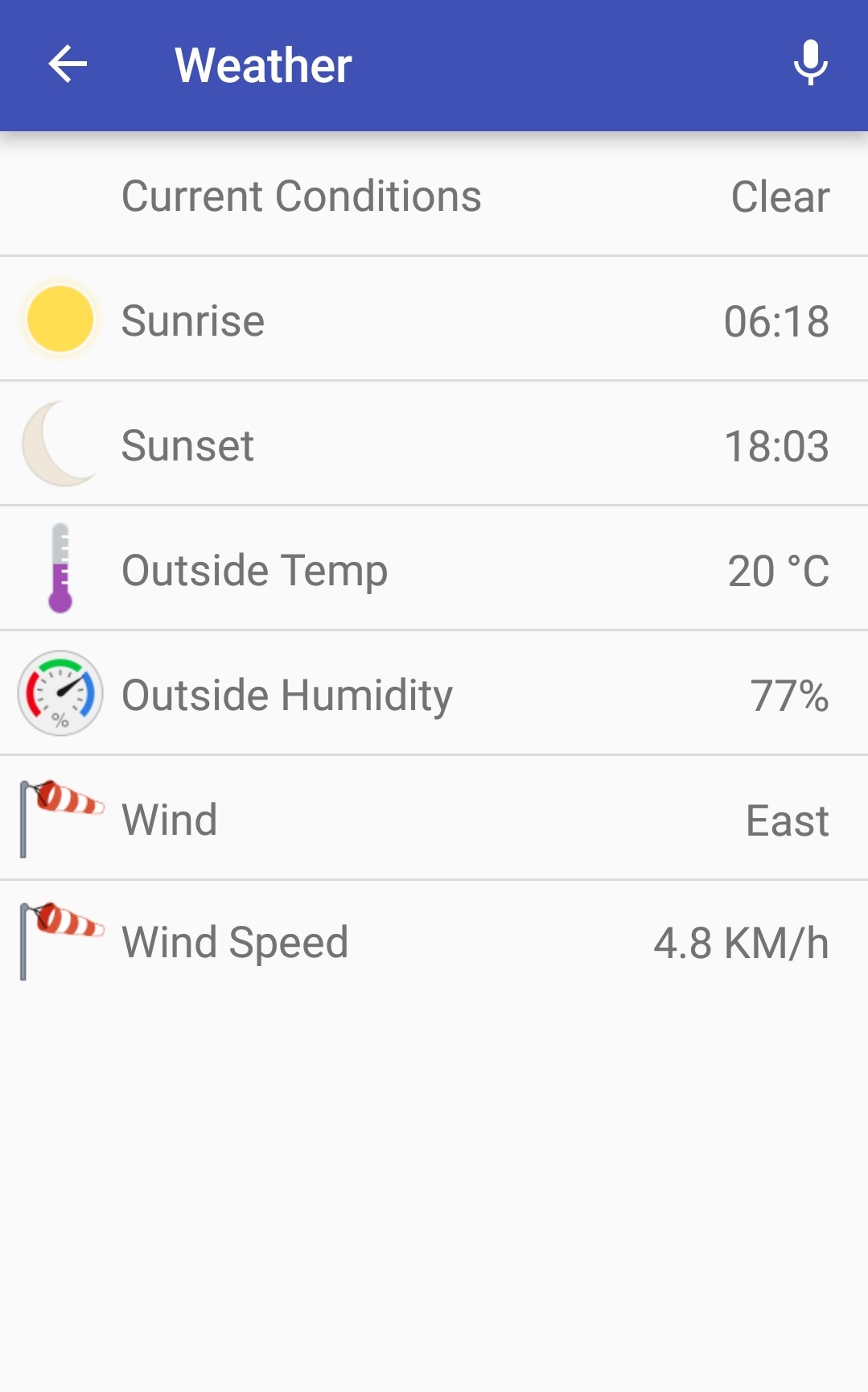

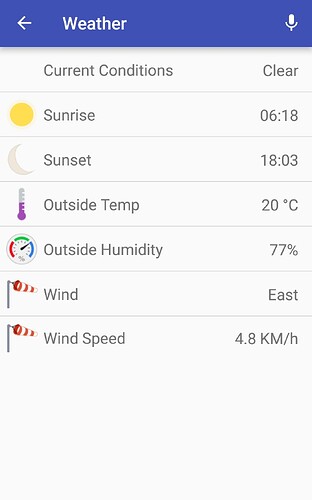

You could combine the astro binding and the weather binding with the cloud cover value in a rule.
This could work, but the nearest weather station is about 15km distance, so many false alarms for me. Thank you for the enlightenment. I never thought of it before
Just for an example for those who do have a weather station close enough.
Switch vIsCloudy "Cloud Conditions" <iscloudy> (gChart)
iscloudy is a custom icon I downloaded. gChart makes this Item be persisted for charting. See Design Pattern: Group Based Persistence.
I’ll not show the Weather Items but you can find them all here: Comprehensive Wunderground using HTTP Binding Example
rule "Is it cloudy outside?"
        Item vWeather_Conditions changed
        logInfo(logName, "New weather conditions: " + vWeather_Conditions.state.toString)
        val isCloudy = transform("MAP", "weather.map", vWeather_Conditions.state.toString)
        val newState = if(isCloudy === null || isCloudy == "false") OFF else ON
        if(newState != vIsCloudy.state) logInfo(logName, "Setting isCloudy to " + newState.toString)
        vIsCloudy.postUpdate(newState)
weather.map has a mapping from all the conditions that Wunderground supports to true or false to indicate whether the condition indicates it is cloudy.

I wanted to post pictures, but to be honest it wouldn’t look like much, its mostly small sensors and lights…
So this weekend I installed and configured both the Astro and the Weather (wunderground) plugins. Both work amazing.
Using the Astro Binding I can now effectively turn the lights on and off as needed. I think I’ll need to set an offset though, as it is somewhat dark already 5-10 minutes before sundown inside my house.
I also found that someone has a Weather Station ~3km from me, so I can get a somewhat accurate reading of the weather using that, and it works great.
I now need to still implement rules to turn on the lights earlier if it is close to sunset but cloudy.
