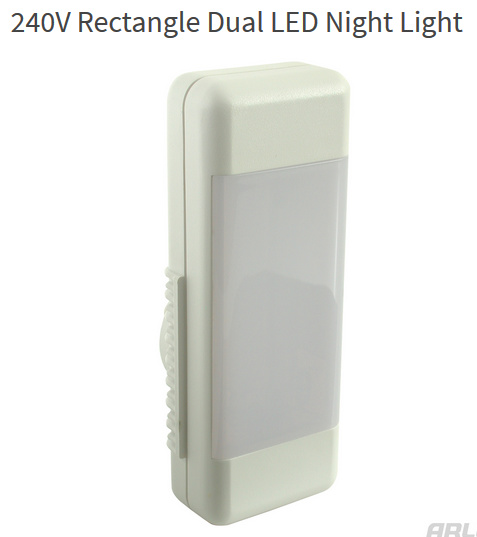

I’ve started by buying a $10 night light which runs off 240V and has some bright LEDs in it. The plan is to use the existing power supply to run a wemos D1 mini with a bunch of sensors and NeoPixel stuffed into it.

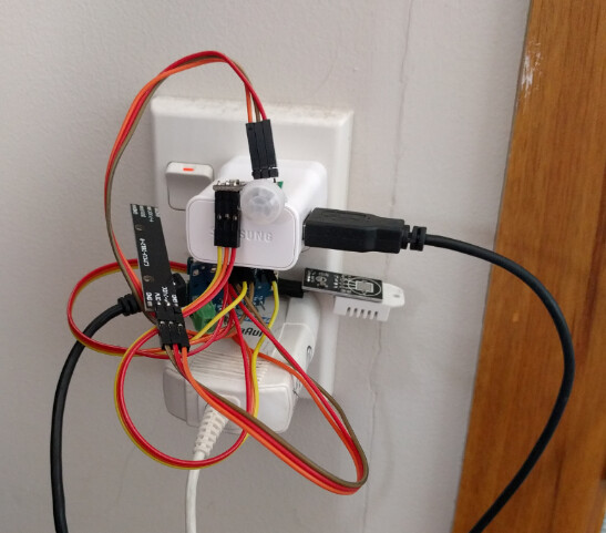

Okay pictures speak 1000 words… I’ll explain how for I’ve got and how a little later.
This is the test rig (ignore the toothbrush charger below it)…

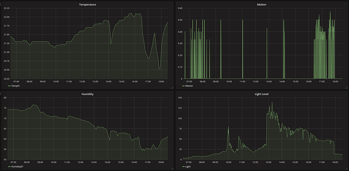

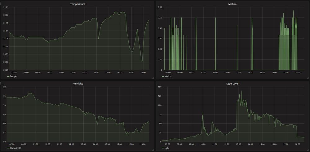

And this is some data coming from it displayed using Grafana…

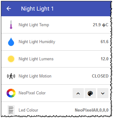

And this is what it looks like in the sitemap for now.
