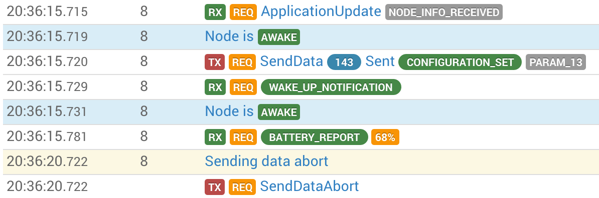

There’s nothing obviously wrong - the binding is trying to send the requests, but the device isn’t responding. The only thing I can think of is that according to the manual, clicking on button 2 sends the NIF, and then the WAKEUP NOTIFICATION. I see this in the log, and the binding sends the request with it receives the NIF (since it treats it the same as a wakeup since most devices assume this is the case). The binding therefore sends the request, and then receives the wakeup notification - the request then times out. Maybe this device is different and isn’t really awake until later.
I would suggest waiting for the routine wakeup and see if anything changes.

Maybe, but OH2 might be different with timing, so I don’t think you can just assume it will be the same. At the moment, all I can really say is what I see in the log - I’ll paste it below so you can see what I mean -:
This clearly shows the NIF received, then the binding sending the CONFIGURATION_SET command, and then the WAKEUP_NOTIFICATION is received. The device does not respond to this - I’m open to other thoughts of course on how to interpret this but it would be interesting to see what happens when the device wakes up by itself.

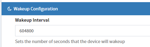

I will wait for the node to wake-up by itself…Although I hope this is an error:
(that’s 7 days)
It’s probably not an error - it’s probably been read back from the device. If the device already has a value set, then the binding won’t override it - if it’s set to 0, the binding will set it to 1 hour…
