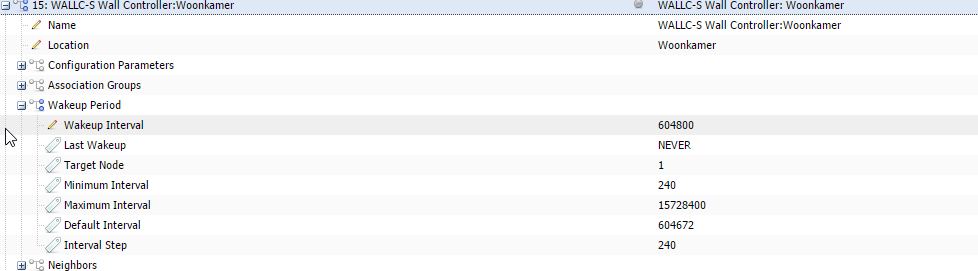

Hi dries_dokter,
I was triggered by your remark on battery life. I searched on Internet how to get the most out of a battery, and the answer was about lowering the wakeup interval. This is my config on wakeup:
Maybe this setting will help getting you also more than two years out of a battery. But of course during configuration and putting it again and again in management mode will drain your battery in no time. It has also the ten days wakeup interval, which you think it is an error.

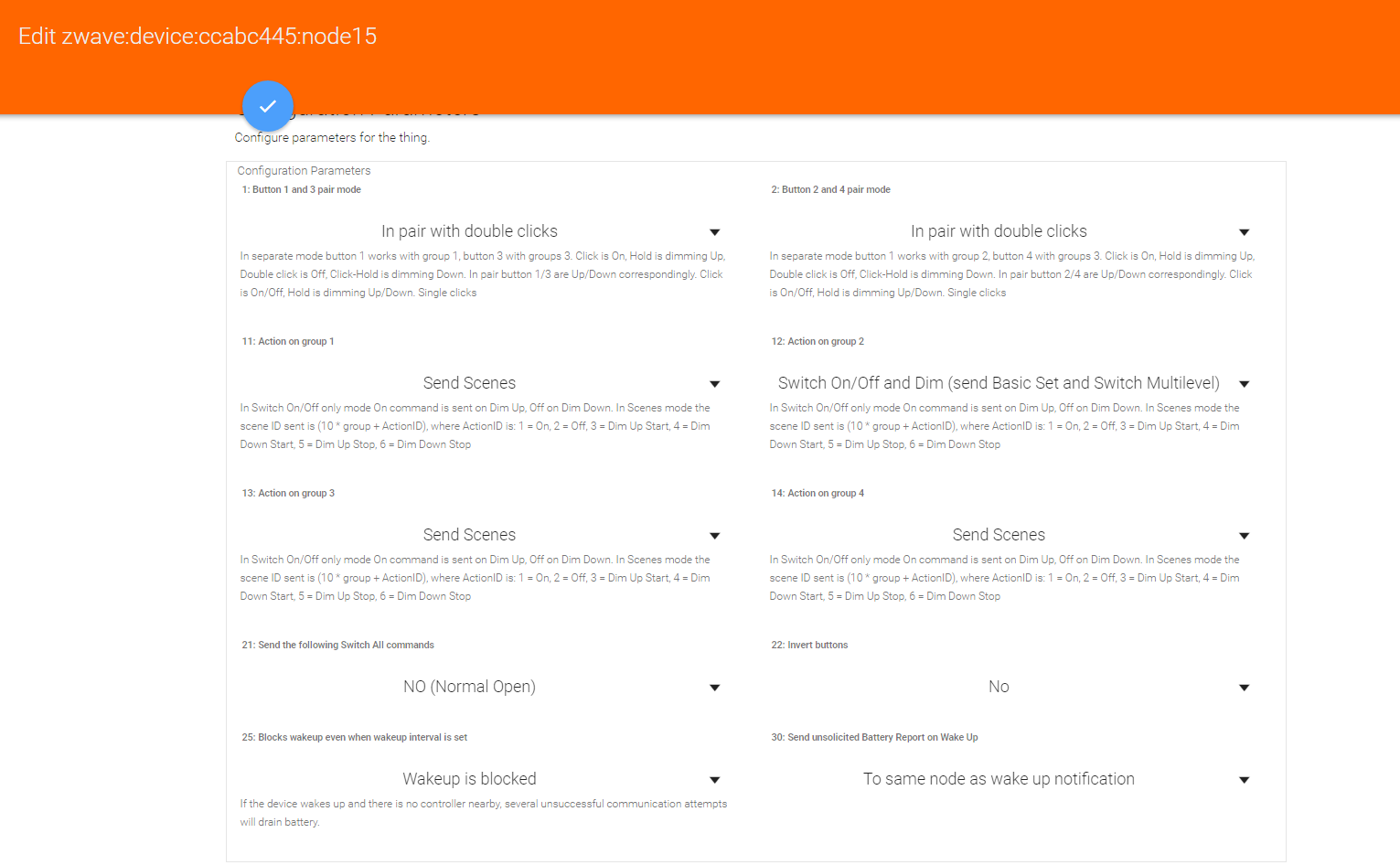

Thanks for logging settings! I did some testing with the latest cloudbees build. I was able to add a new Thing, called called WALLC-S. So that is nice to start with.

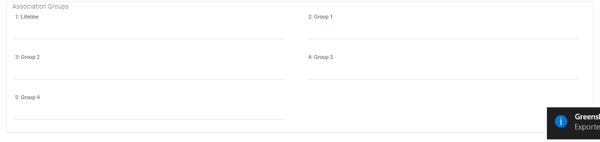

It is recognized with the correct configuration: for four groups A, B, C and D. Three groups are sending scene numbers and the other group is associated with a fibaro dimmer.
The next image shows the group info. It seems that the group info is not shown? Scene sending groups are associated with the ZME_USB1 z-wave stick.

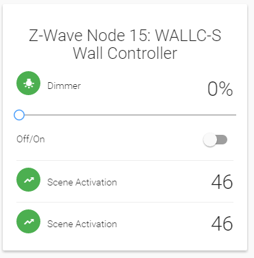

After the device is accepted as a Thing, the following appears:
I am not sure what to expect. I think that there should only one scene activation entry. When I push the different switches on the WALLC-S, both the scene activation numbers are changing simultaneously.
All scenes of the three groups are reported.

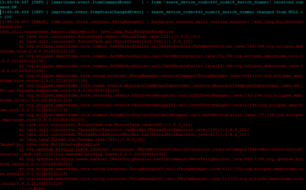

The dimmer configuration seems to be correct. However it is not updated when I push the buttons. In the log some error warning is shown:
