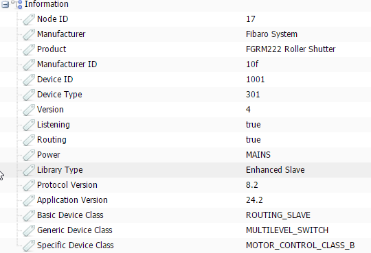

Can you confirm the version of this device? Fibaro seem to have started with these strange version numbers and I know for example that version 2.5 is reported by the device as 25.25, so I wonder if this is version 2.2?
Regarding the WALLC-S not being detecting now, If this is the same issue as I describe above then there’s likely to be a timing issue which might add to the variability. I’ll try and take a look at the log later.
Hi Chris,
For your information, OH1 reports it correctly (to be more precise all items are working fine in OH1). I hope that the next picture contains the information you need:
Hmmm - even more confusing unfortunately as I don’t know if this is correct either… What is written on the box (if you have the box) or the manual that came with the device, or even the device if you can access it might have the version…
OH1 has the wrong database though that’s the problem. The OH2 database has added new devices to account for different versions, so it would be good to understand exactly what version this is…

Hi Chris,
Thanks for explaining. Below the information found:
I have the box and the manual. From the box:
  • Roller Shutter 2
  • Product code (bar code on box) 5-902020-528227
  • A sticker is on the box which says: 12/2 EU, 23-03-2015
The manual states: Fibaro Roller Shutter FGRM222 v2.1-v2.3
Other version info is not mentioned in the manual.
I do not have access to the module itself.
