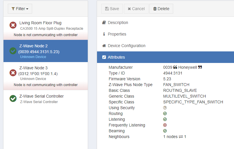

I’m also having some struggles. I have a fresh install of Openhab and testing if 3 different z-wave devices will work. One works, the CA3500 outlet, and the other 2 get the unknown device error. They are Honeywell ZW4002 and Inovelli NZW31. I see these 2 in the database but I can never get them to the point where I can control them with Openhab like I can with the CA3500. What can I try?

As I installed 2.3 from RPM I had the same struggle as back then. It did not matter how many times I manually woke up my wall-c switches, it just was not picked up in openhab2
So I took the the forum and revisited this thread just to see that it was “revived” and I saw the mention of the zwave 2.4 dev version. Installed it, removed the zwave things, did a rediscover and woke-up one of the switches manually immediately it was updated from Unknown to Wall-C!
