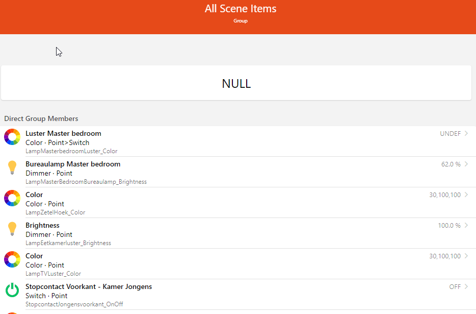

  1. First of all, I have only one group that contains all “scene-enabled” items, it is just a basic group that will be used in scripting later on.
Properties of this group:
Content of this group (as you can see, mixed item types: bulbs and power plugs):
Each item I want to use in a scene MUST be in that group.

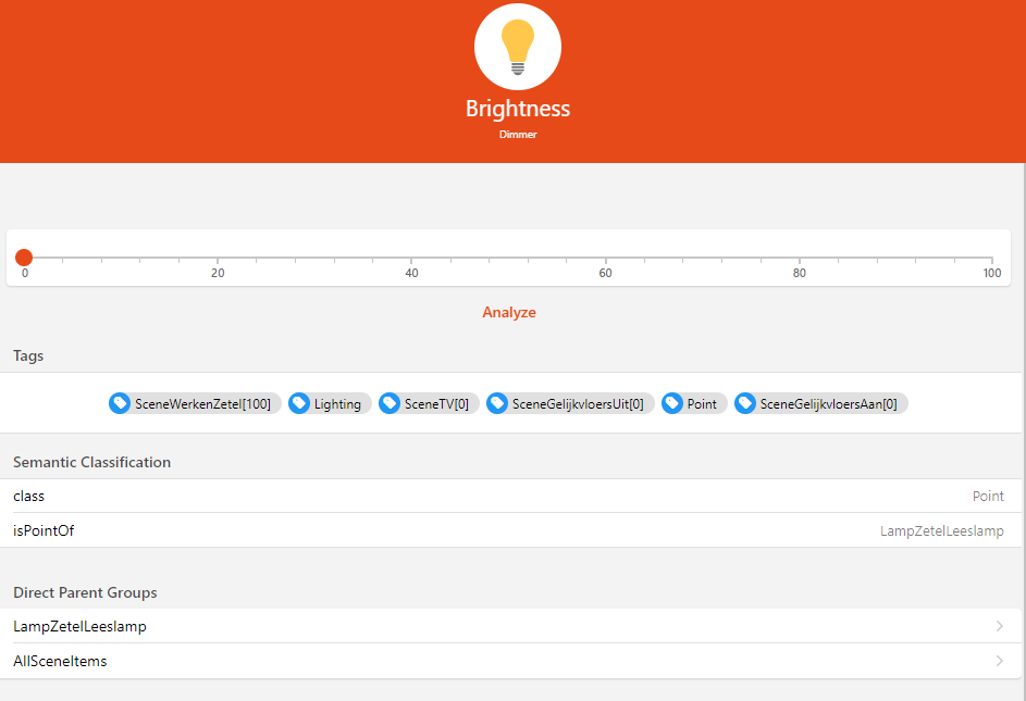

  1. Also, that item has a tag that represents the config for a certain scene. The format of that tag is “Scene[]”.
    In this way I can assign several states, including an “off” state.
By using this method, I keep the scene config as close to the item itself without having to mess around with groups or scripts per scene.

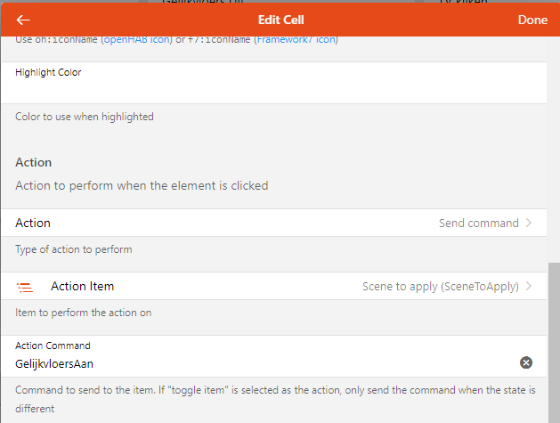

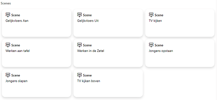

  1. Now all that’s left is to create buttons on my overview (or any other) page for each scene.
    This can be accomplished by using a default cell, select item “scene to apply” and set action to “Send command”. The value for “Action Command” is the name of the scene (without the prefix Scene) as configured in your item (see 2)
Choose a fancy icon and you might get something like this:

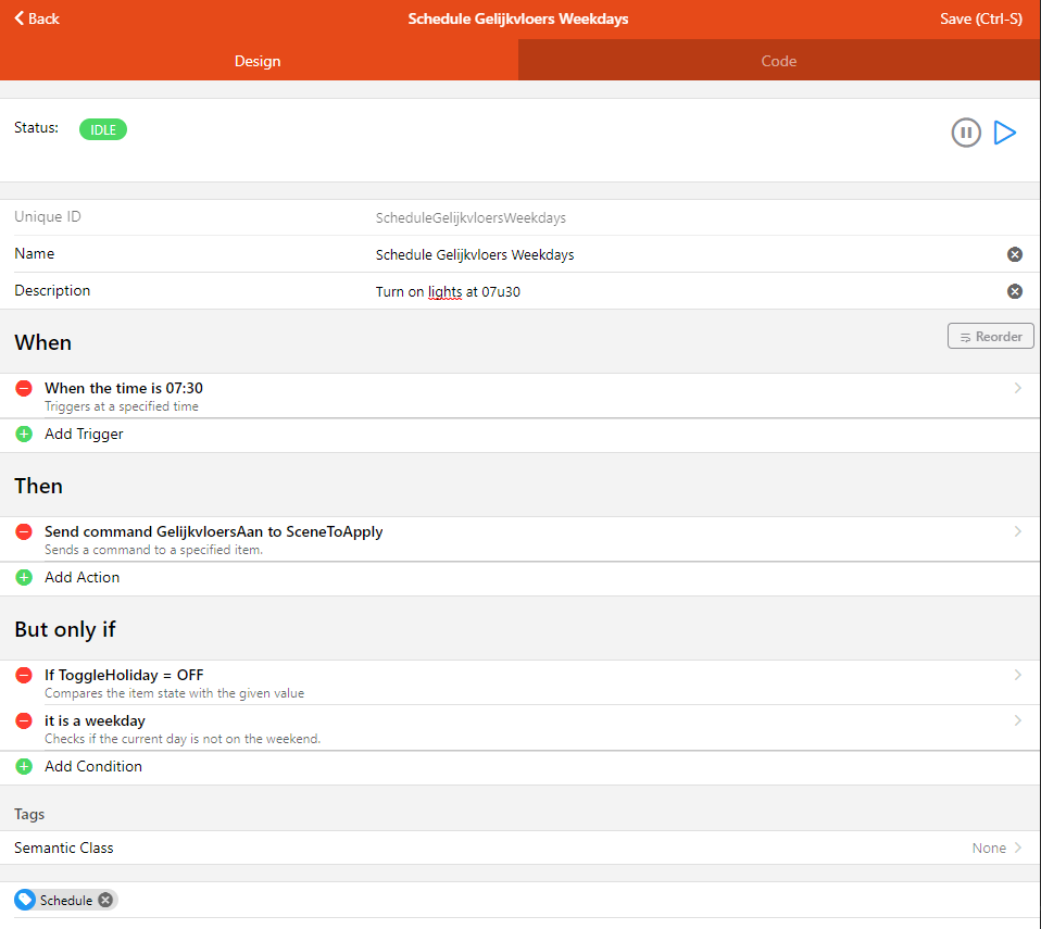

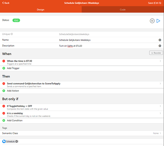

  1. You can schedule a scene simply by using the logic of step 6 in a schedule, nothing fancy.
    e.g. turn on the lights on weekdays at 0730 except when it is a holiday (might be material for another post?):
