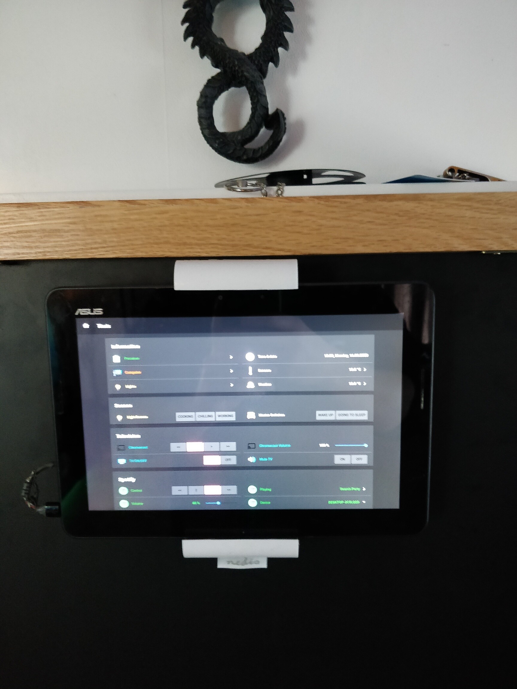

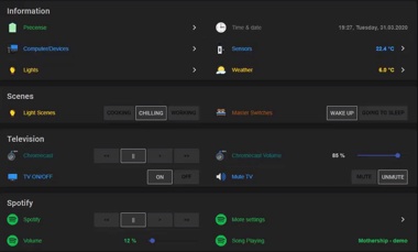

This is my Wall Mounted Tablet:
This is my sitemap:
I choose to use a Kiosk app for the tablet and display the sitemap trough the URL.
In my opinion the openhab app doesnt look as clean as this. I hope in the future it will look better.
BTW im a big fan of the sitemap in Openhab, HABPANEL looks (for me) very chaotic. The sitemap is much more cleaner for me.
When walking in front of the tablet it goes on automatically trought the front camera that detects movement.

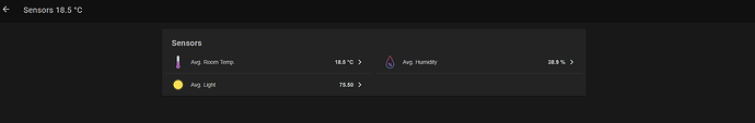

I used little trics (Like visibitlity) in my sitemap to keep it clean.
Like this:

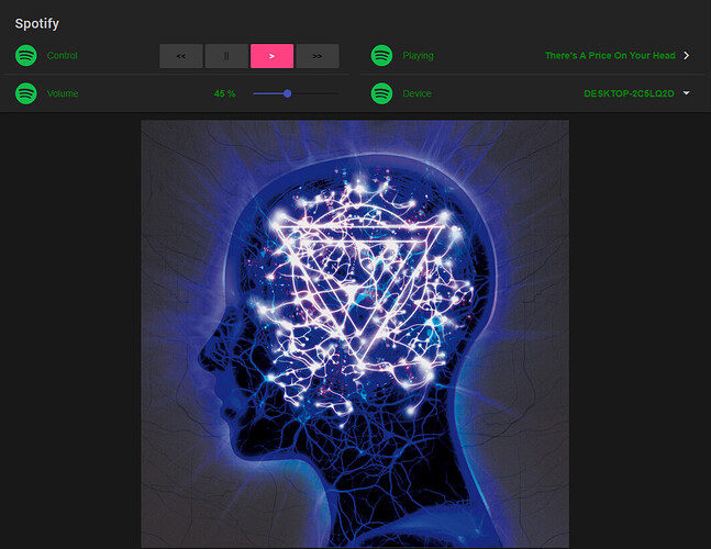

When spotify is playing there appears more settings and the album cover.
This also helps with HTML images that dont work outside your house when youre on the cloud connector. I used visibility option in sitemap on those images connected to my presence item. So when presence is off, those images disappear.
I use the lights scenes alot, i have a small studio and the tablet is in the center of my house.
So when i go cooking or need big lights the tablet is the first thing closest to me to turn the lights on or off.
When leaving home or coming home i use a presence item to turn everything on and off.
I use the ARP bindings for this so Openhab knows when my and my girlfriends phone connected or lost connection with the router.
Because of that i have no need to turn any button, i just leave my home and after 4 minutes (expire item) everything turns off (Computer, tv and all the lights)

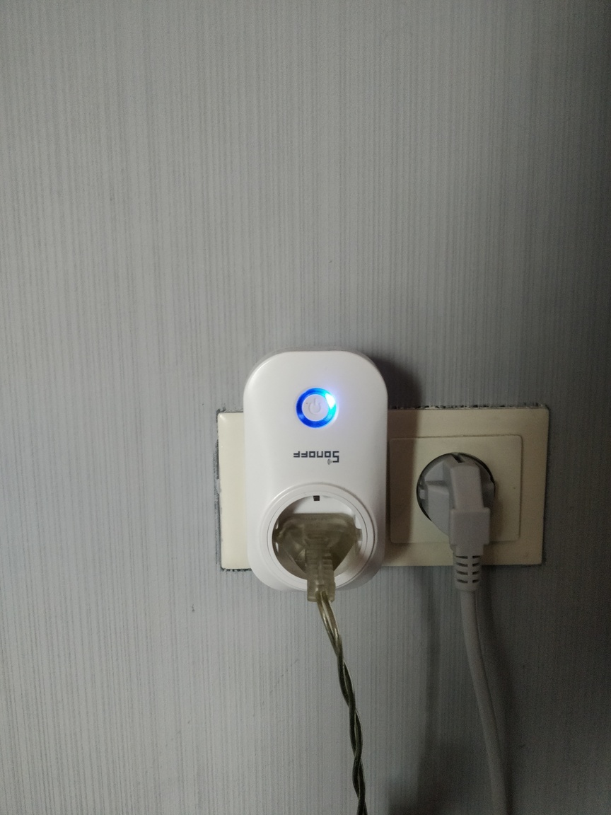

  • SONOFF Basic and Wall contacts (Soldered and put ESP program on it to use them with MQTT)

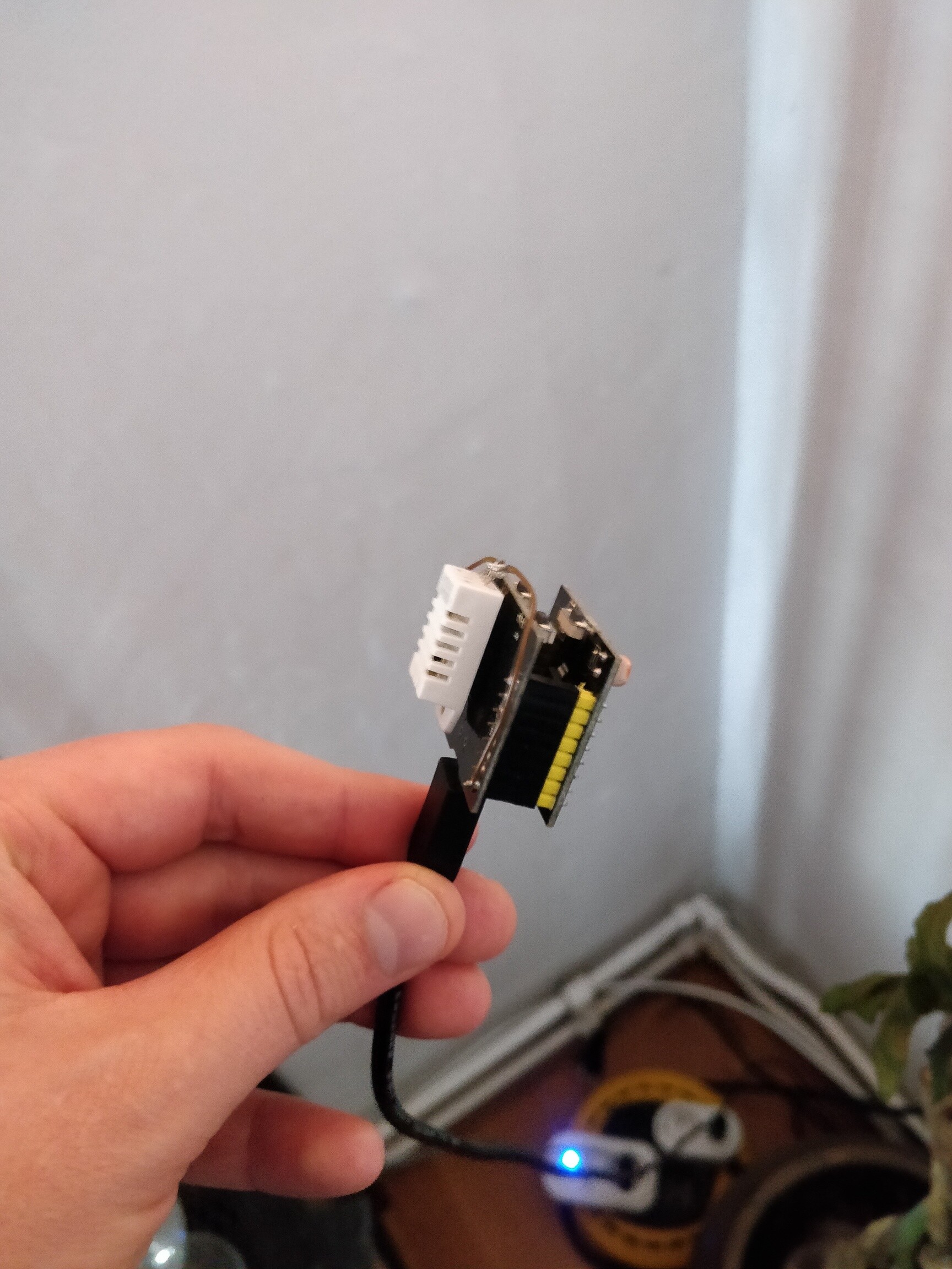

  • WITTY boards with DH22 sensors to see temp, humidity and light in house)

SONOFF contact
Witty Board with DHT22 sensor

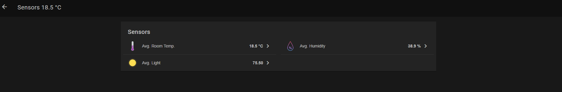

Added Custom CSS code into sitemap:
Added grafana graphs for home sensors:

Awesome thank you! I got it working great. Two questions: Where in your site map did you drop in Webview url=“/static/HideHeader2.html” icon=none
I added it to my site map but its dropping all of my menu pages down.

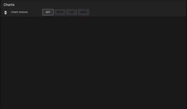

Also how to set up you charts like that where it will select different pages based on what button you push?
At the bottom of the sitemap file before the last syntax “}”
The charts i made with a dummy number item:
Number Chartdummy
And then made this in sitemap with visibility option:
Switch item=Chartdummy label="Charts Sensors" icon= "humidifier"  mappings=[0="OFF", 1="Hour",2="Day",3="Week"]
			Webview url="http://192.168.2.108:8080/static/grafanauur1.html" icon=none height=12 visibility=[Chartdummy==1]
			Webview url="http://192.168.2.108:8080/static/grafanadag.html" icon=none height=12 visibility=[Chartdummy==2]
			Webview url="http://192.168.2.108:8080/static/grafanaweek.html" icon=none height=12 visibility=[Chartdummy==3]
So because the dummy is a number item, and in the sitemap is a switch item, the mappings are key.
So you make buttons 1, 2, 3 and 4
And give the things you want to show the right visibility command.
So item number 1 wil only show when that is selected.
Hope you get this. Playing with visibility is a great way to make your sitemap look clean. You can use that command on frames also. So when you want a frame only shown when you are at home or you turned something on you can use something like this:

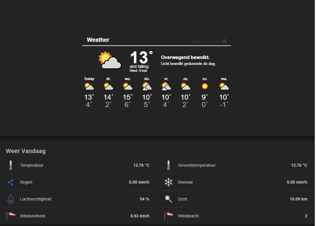

Or with presence:
	{Frame label="" visibility=[Presence==ON]
		{Webview url="http://openhab:8080/static/weather.html" icon=none height=11

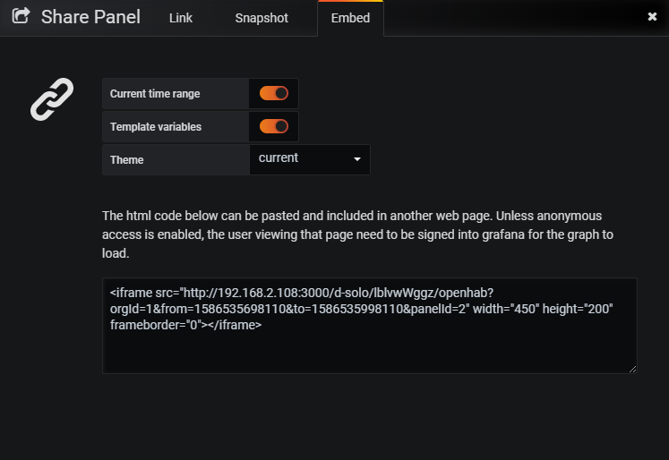

Thanks again for sharing this information! I set it up for a few different use cases and now am setting it up for the grafana. Can you advise how you were able to get the URL’s you are using? The tutorials I have seen say to use the render image button in Grafana but that outputs a long string URL. Thanks again.
He @tinkernut
Yes, i use the embed share option:
Just copy the code into a html file:
<html>
    <body>
<iframe src="http://openhab:3000/d-solo/lblvwWggz/openhab?orgId=1&from=now-1h&to=now&panelId=2" width="500" height="200" frameborder="1"></iframe></html>
<html>
    <body>
<iframe src="http://openhab:3000/d-solo/lblvwWggz/openhab?orgId=1&from=now-1h&to=now&panelId=4" width="500" height="200" frameborder="1"></iframe>    </body>
</html>
<html>
    <body>
<iframe src="http://openhab:3000/d-solo/lblvwWggz/openhab?orgId=1&from=now-1h&to=now&panelId=6" width="500" height="200" frameborder="1"></iframe>    </div>
    </body>
</html>
So this is 3 different graphs in 1 html file. So it will make 1 webview of it, ofcourse you can also have them separate.
And then add the webview to the sitemap.
You can change the time with this:
Hour= from=now-1h&to=now
Day= from=now-24h&to=now
Week= from=now-7d&to=now
etc
