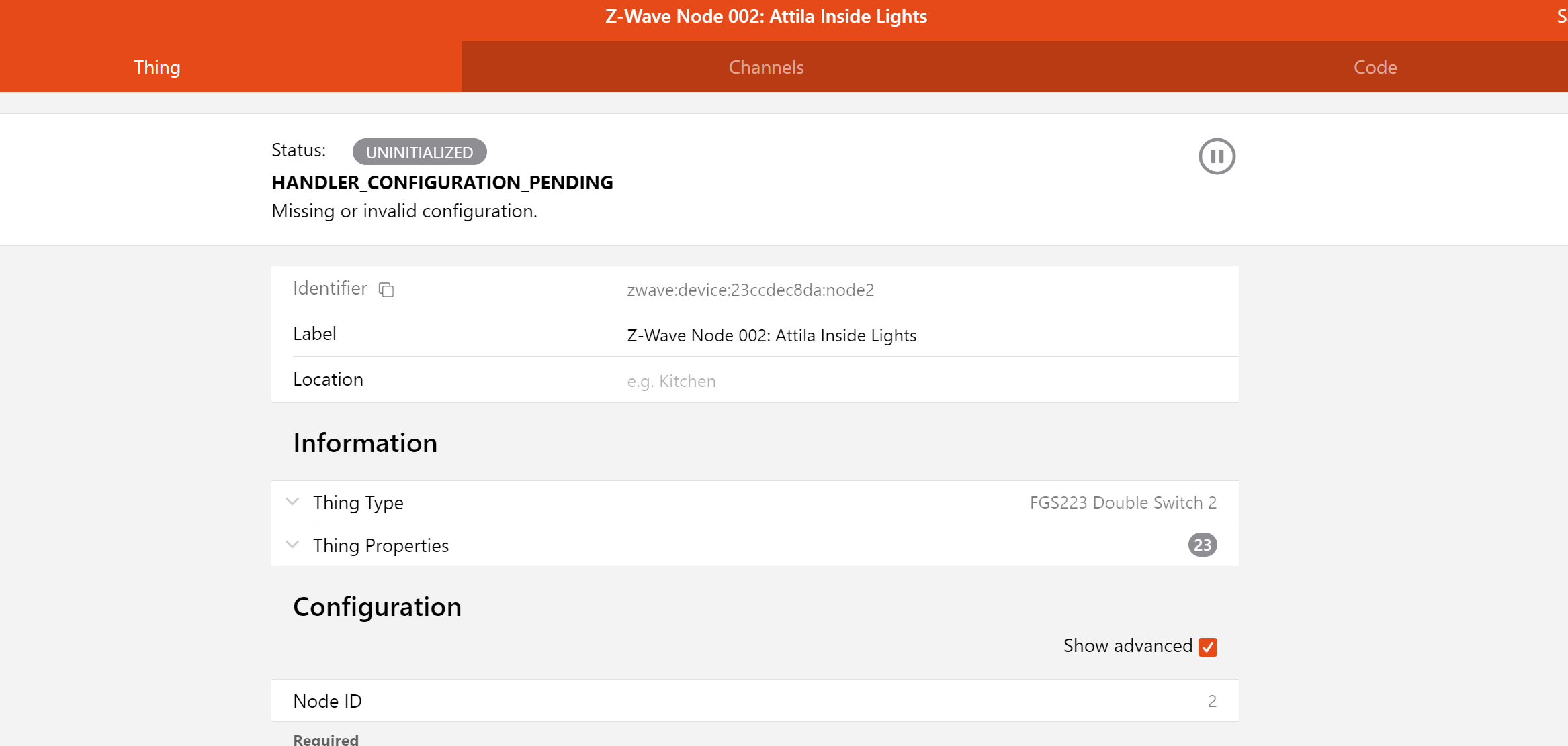

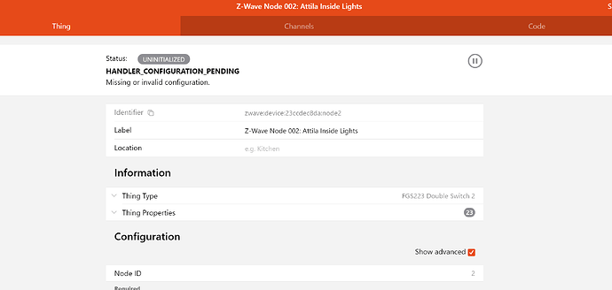

Sorry @chris it was the Fibaro FGS223 node 2 on my test controller from the screenshot. All parameters are within bounds for this device but it does not initialise as expected but can be fixed by saving the thing configuration with no changes made.
Thanks Rob - so the within bounds, but the node doesn’t initialise after an OH start, but you save the thing, and it then starts - but no config (apparently) changes?
Strange. If this is the case then I guess there’s a bug in the core (which sounds likely if this issue is hitting other bindings as well).
Thanks for checking this - it saves me doing it which is appreciated
Thanks. This is a good device to check as it only has 4 parameters and I can confirm that the defaults are all within limits so the validation should pass I think.
It doesn’t look like this is a problem with ZWave binding in general - that’s not to say that with these extra checks we may not find some (with around 1200 devices in the database - something is bound to pop up ) but at least for this device I think we can say it’s a core issue.
