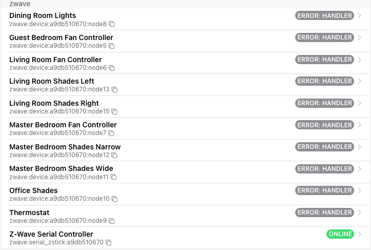

Now my all my Z-Wave things are borked.
Office Fan Controller was not working before.
Do I have to redo all of my Z-Wave devices?

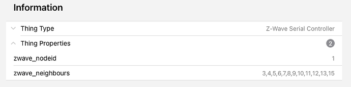

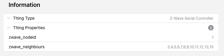

My Controller properties shows a node, 3, for which I don’t have have Thing
My Things
I believe that the inbox items represent the same Leviton Fan Controller, and there was an inbox item as Node 3 with the same address that I deleted.
I’ve performed soft and hard controller resets and Synchronize network on the Controller Thing. No changes
I’m almost ready to factory reset the dongle (HUSBZB-1) and start over.

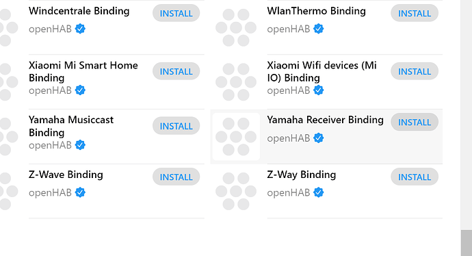

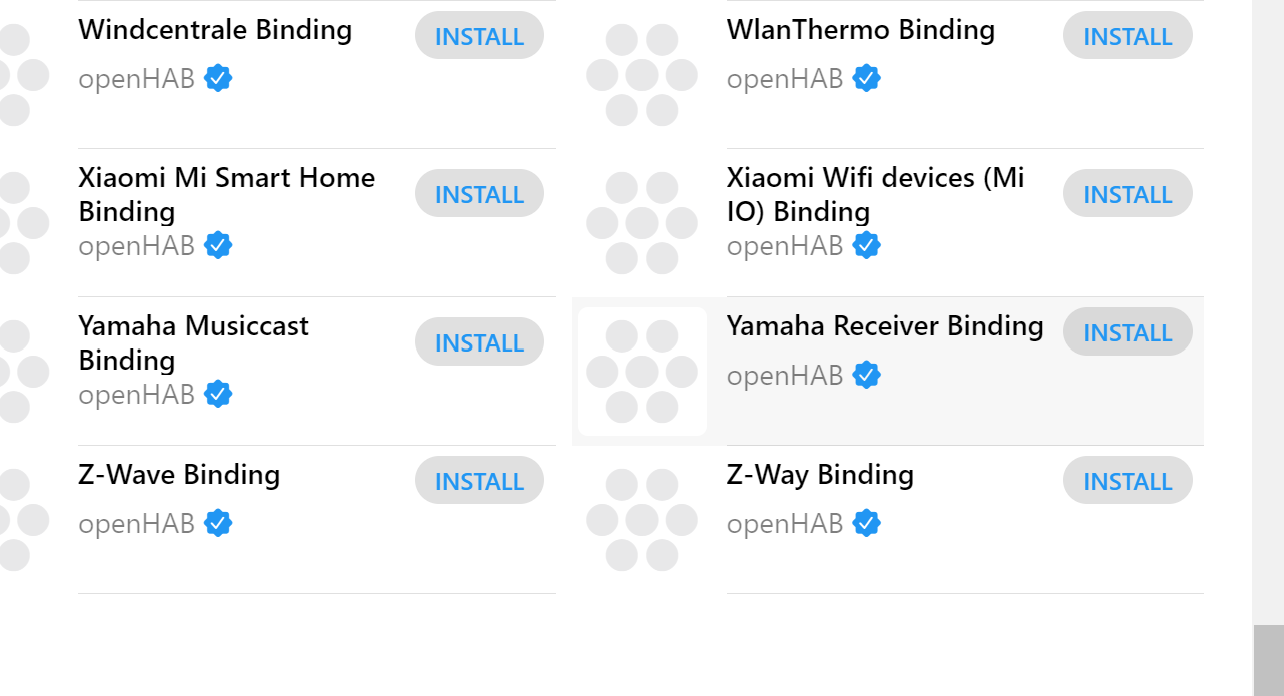

Just installed latest snapshot on a working instance and it looks like the z-Wave binding is not installed immediately after upgrade.
I reinstalled the binding and restarted.

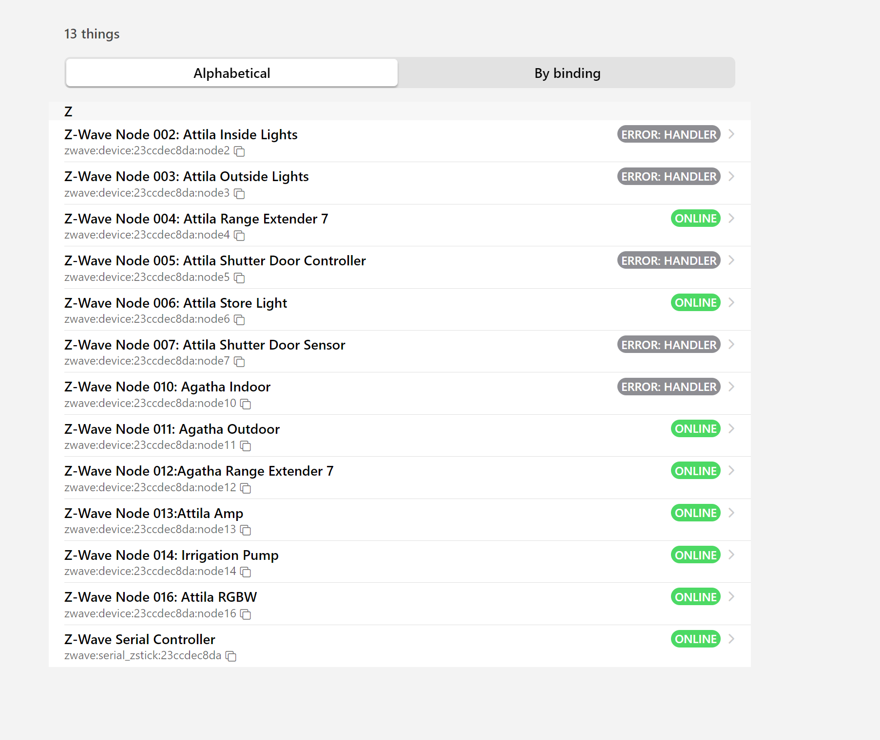

and it looked like this
went to each device with an “issue” and saved and the device immediately displayed online.
I foolishly did not try controlling the devices before doing configuration and save.
Possibly device is online but new code is preventing status being updated as parameters are failing validation?
Or device needs a save to make configuration correct so it initialised.
When I test by disabling the controller and enable it again the same devices showing error:handler and can not be controlled. Going to the thing config and saving fixes and devices behave as they should.
Based on all the discussion by the OH heavy weights I think you may have more than one problem. As to my Node 3 comment, it was late last night and I didn’t elaborate. The problem (seen with the log viewer) was that several messages to Node 3 were timing out. It does look to be a levitron ZW4SF_01_008 (fan controller). As to nodes 17-19, they are clearly duplicates and in the debug log only node 19 seems to be active. It is some kind of battery device because I see “wakes”.
A rebuild may not be a bad idea. Hopefully that would clear up the other issue with the configuration PR.
The other thought is to use the Silabs PC controller and clear out extraneous devices and then go to the devices you know you have and check the configurations ala @robmac post.
