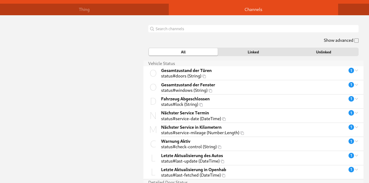

I am using 3.4.5 and below my findings:
The binding is added correctly to the bundle:list →
However myBMW binding desapears for the bindings in the local web interface:
I am not sure I can see some new channels - what are their names?
I will test refreshing time.
Thanks a lot once more!

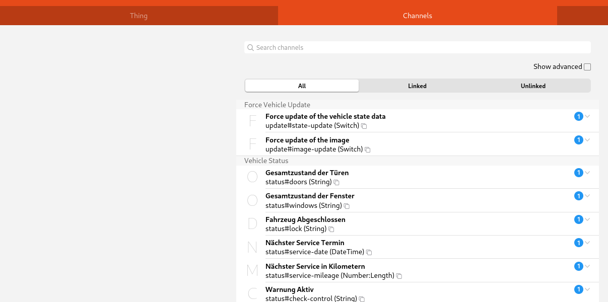

Hi @Tomasz_W,
that’s weird. I see the same in my 3.4.5 installation and no errors in the logs. I just copied the source code from 4.2.x to 3.4.x as I’m not really aware that there were significant changes in the code regarding discovery, but I could be wrong.
Nevertheless if you have a vehicle configured before upgrading, then at least in my installation I see these channels on top:
a newly added vehicle has these “Force vehicle upate” channels in addition:
If you create a backup you could try to remove the vehicle and trigger the discovery by just opening and saving the bridge to get the new channels
