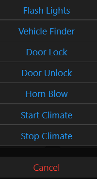

But, a general question; before, I used some old script based bmw interface in oh (probabaly the first available one, since I have had i3’s for quite some time now). In that setup I had a switch “Climate Now”, that I used frequently. I suspect that might be possible with the “Remote Service Command” but how?
Channel remote command contains these options.
Unfortunately I’ve to apply a small fix for `Climate & Charge now. But I think this will be fixed soon! Stop currently not wokring for me!

This is exactly where I’m struggeling a bit:
  • In ConnectedDrive it was just able to start climate-control, not stop!
  • I added the controls for start / stop - starting works, stopping refuses to work
  • In MyBMW App I’m also only able to start climate control
Does anyone have the ability to stop climate control via MyBMW App? And if yes cross check with the binding functionality?

I can start/stop climate in my 330xe using the Android app.
When trying Add Items from Thing only item I can see in the list for climate is A/C at Departure Time (see attached screen copy).

Hi, Using the latest Binding for me Start and Stop Climate works just fine …Thanks a lot for your effort…
Let me know if I shall provide more detailed information.
Service Execution State: Climate Now Stop Executed
