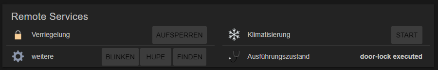

You can send climate-now-start and climate-now-stop to the remote#command channel. It’s two channels up in your picture where you marked the the channel in blue.
Link an item to remote-command channel an when clicking it these options are provided automatically.

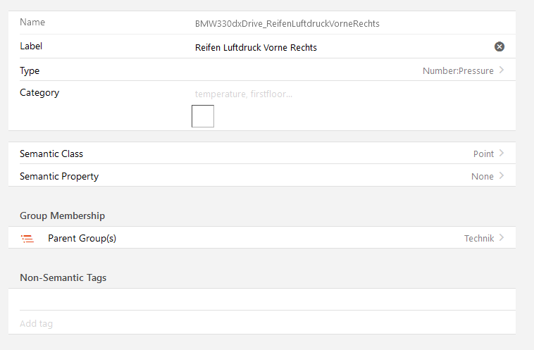

I’m not using textual items definitions anymore. I linked a new item to each of the pressure channels and they stay at UNDEF even after a test drive. This is how one of the items looks like:
My sensors have either unit bar (Tire Pressure Front Left) or hPa (all the other sensors). I wonder how to change the unit from hPa to bar? I have G21 330xe.
I think the problem has disappeared now because all the pressures are correct and have unit bar. The problem appeared right after I had added the tire items into my model. I didn’t make any changes to the Items related to my car but I restarted OH quite a few times because I’m still adding new Modbus Items to my model. I hadn’t driven my car since adding these Items to my model. Many thanks for your great work.
