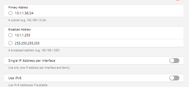

Never seen that WARN before, any ideas what is causing that line? Since it is network related it may be a clue as to what is wrong. Have you selected the network that openHAB uses by default? it is under settings>network settings. Maybe you have mutliple NICs and the wrong one is selected? Are you running in Docker or anything else that may be blocking network traffic?
I find I have to hit SAVE in this screen for it to work, perhaps that does what rebooting does for Rich.

  2. Settings Network.
    All looks fine. Only one network interface on the device.

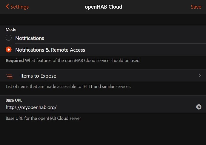

  4. And here is my openHAB Cloud settings. Saved/Rebooted multiple times.
So .. no idea what is configured wrong on my side.
