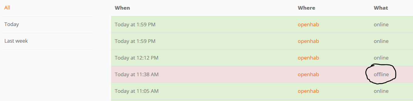

What I was after is the state displayed in my myopenhab.org events:
So the actual connection state between myopenhab.org and my raspberry pi with OH.
