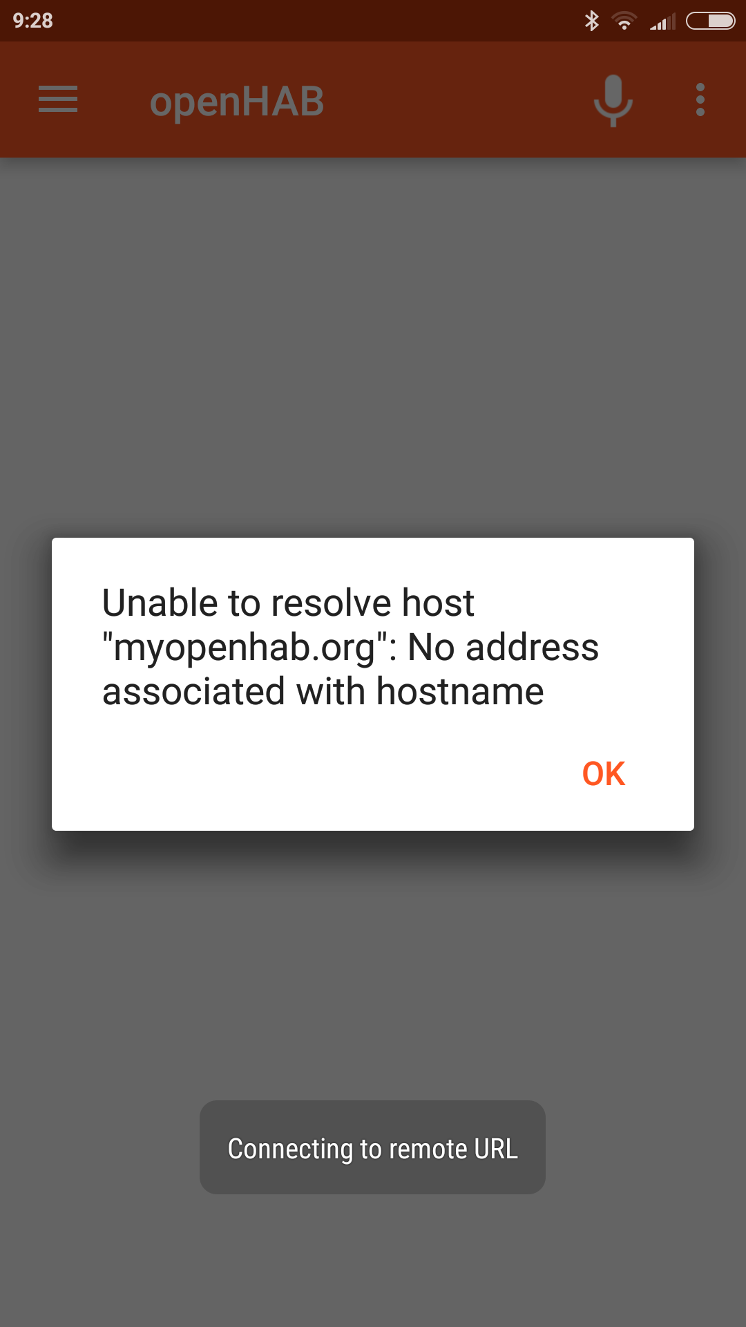

OK, I change the settings so the local URL is something that probably isnt taken on that network, I see the app trying to connect to the remote URL, but there is always an error message of some sort, such as timeout or whatever, or cant resolve host.
habdroid
Now ofcourse it could be that that one network has a problem, so I tried another one and onother one, and another one, all similar… but back home it works again.
