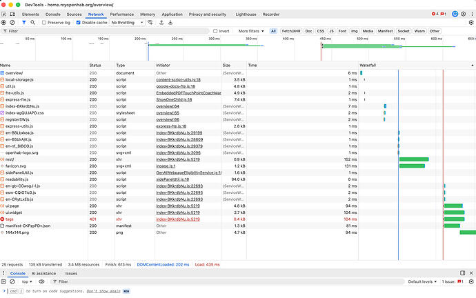

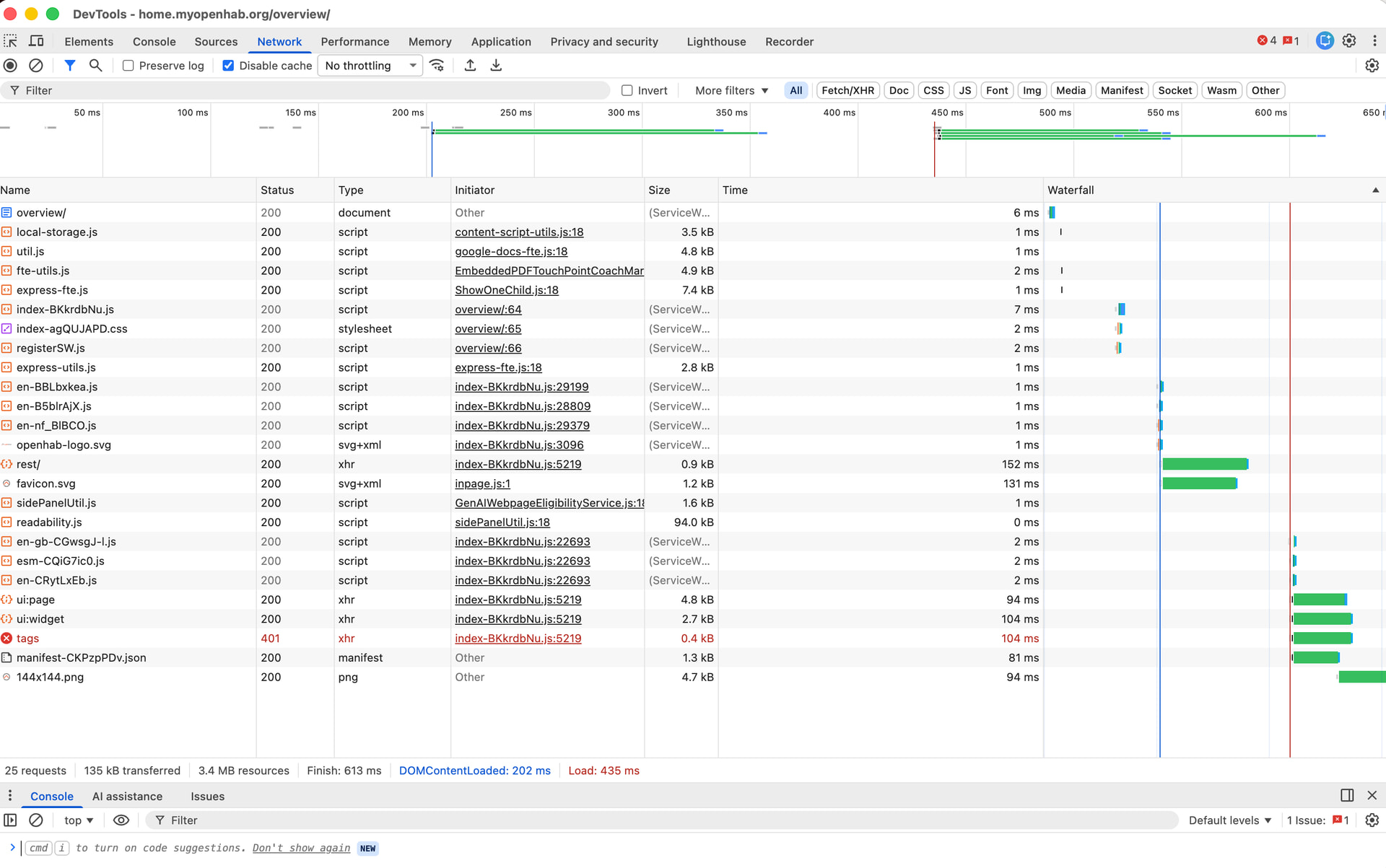

When I access https://home.myopenhab.org from external browser (Chrome, Safari, Firefox is the same), I get blank page and the DEBUG logs show exactly those Jetty errors on /rest/events/states.
I’m attaching as many lines of the log as possible here:

Can you open your browser dev console and show the network tab? I’m curious which calls succeed and which are failing .
Yep:
Do you have the Implicit user role disabled in the API Settings?
Yes Florian, Implicit user role is disabled
wooo, I tried enabling implicit user role and now it works. I never touched this parameter in previous versions (and I don’t know if it was active or not) but how could it be disabled?
Thanks a lot for your help!!
I’ve just fixed a bug in the last days where Main UI wasn’t working with implicit user role disabled, see 5.1.0.M3: Main UI shows blank screen on Android - #50 by florian-h05.
Maybe you touched it and don’t remember, I haven’t heard of parameters that magically change yet :wink:
